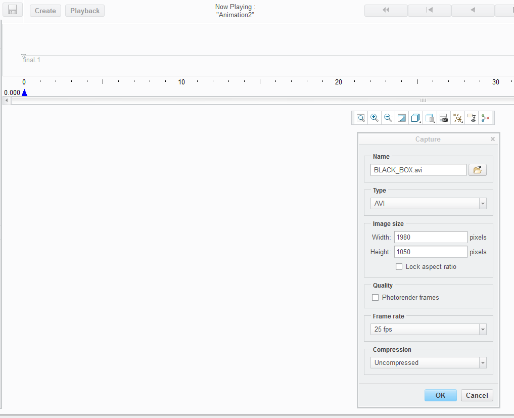

in the animation what is best method for exporting video in creo 2.0 . is there any way to export it to HD format
Best answer by mbonka
My tips about better render animation settings:
1. Do you want 4:3 or 16:9? l already use these size when l need a presentation via projector.
- 4:3 --- 2400x1800
- 16:9 --- 2400x1350

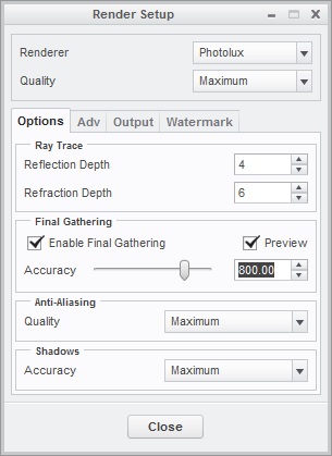

2. Set your render option (if you will render your animation)
ACCURACY --- something like DPI
ANTI-ALIASING --- edges will be smooth
SHADOWS --- shadows will be "smoother"
3. Set 50 frames per second

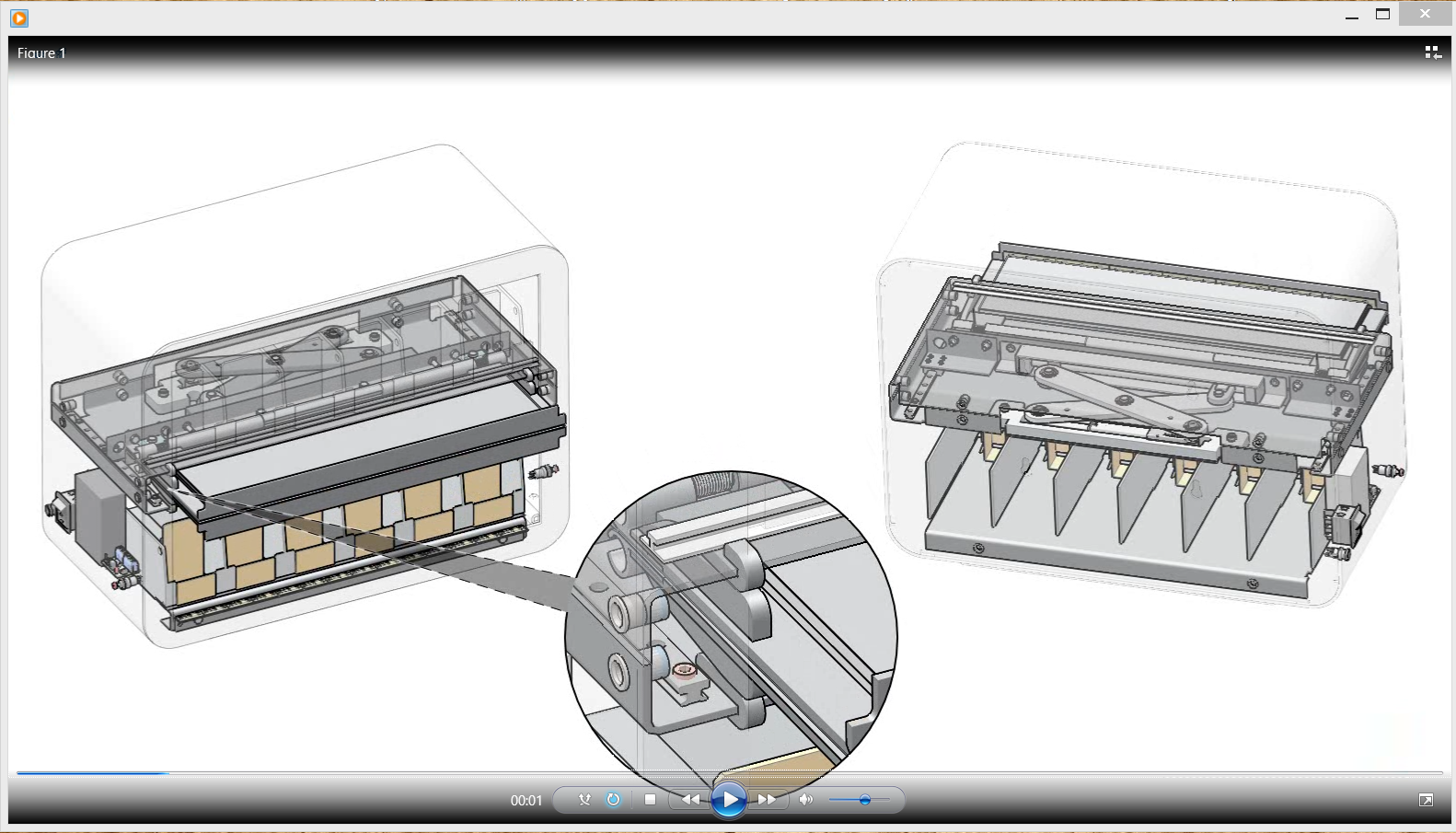

You can define resolution of video you are making and type of compression. HD is no problem. At least this is how it looks in Creo 3.0.
I dont think much changed since Creo 2.0 regarding this.
Best way is (for me) opening model in Creo illustrate and exporting video from there.You can also import .fra file made in MDO in Creo You can have callouts in animation and more options with model appearance.
This is still from illustrate made animation video for example:
