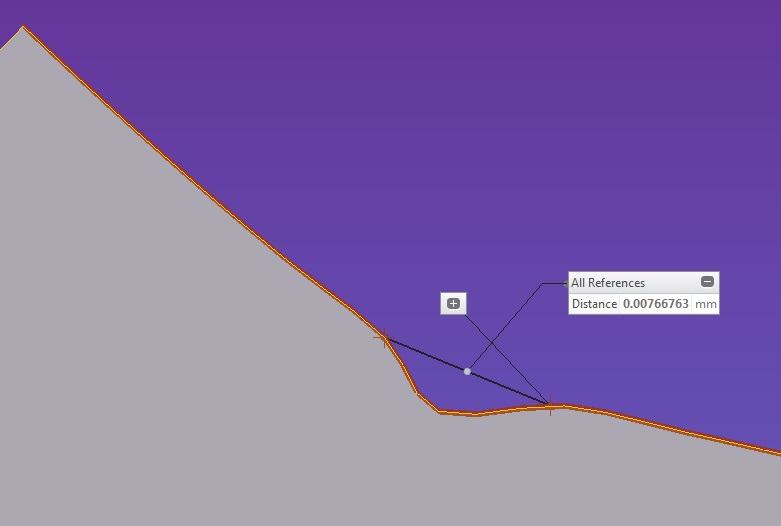

Hi all,
The regeneration fails while trying to extend surface with 3.0 mm of distance. I tried differente accuracies values a and Quick Fix but it still failing.
Attached video with steps and data
Thank you in advance
Best answer by kdirth
The flattened quilt has many small fluctuations such as:
small entities
These features cannot be extended without the edges running into each other creating a conflict.  Changing the part accuracy will not help.

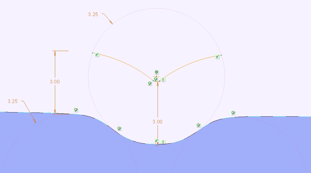

My suggestion is to created a new flat surface using the Fill command.
Use lines arcs and splines to sketch the new shape over the original, eliminating and smoothing out the variations in the edge of the flattened quilt.  You may need to play with any splines (too many points will make it harder to get smooth enough) created to get them to work with a 3 mm extension.  Also any arcs created must be greater than 3 mm to work.  This is the only way I know of to extend your surface as the existing surface edges are too "dirty".
Below is an example of using arcs (construction features) fitted to one of the smaller features and the extension that would result.

The curvature of many of the splines created by flattening the quilt is to tight to extend 3.0 mm.  (cannot extend a 1 mm radius 3 mm).
If you are not looking for high accuracy, you may be able to create a Fill surface and use lines, curves, and splines to approximately "trace" the outline of the quilt and then extend that quilt.
offset
