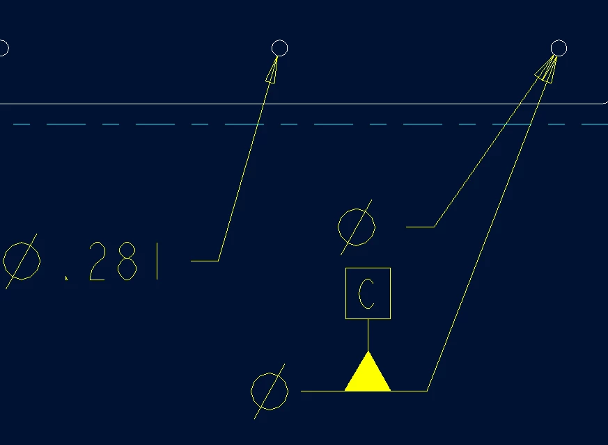

Is there a way to extend the extension line of a dimension for either a radius or a diameter?
The diameter symbol above needs to be extended similar to the diameter symbols attached as a note.
Thanks, Dale
Best answer by Chris3
Hold down shift while selecting and dragging it.
Chris3
Chris321-Topaz IAnswer
October 16, 2018
Dale_Rosema
October 16, 2018
Just remember it is the shift key [and not the control key   🙂  🙂  🙂  ] Took me a few tries.
