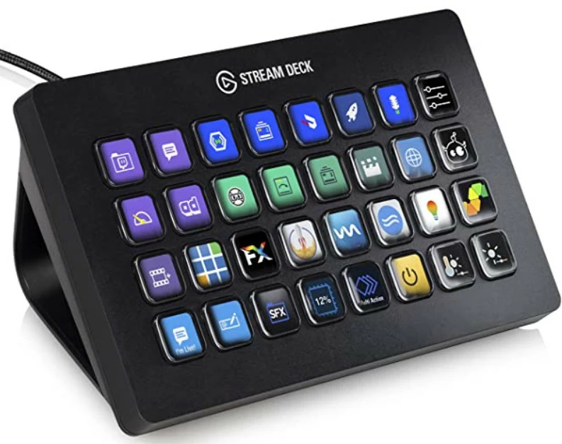

I've buy Stream Deck XL.
Very fine for my mapkeys and folders, sub-folders.
I highly recommend it !
Even if it's made for video streaming, I can program all my Creo Mapkeys 😉
I save a lot of time !
Each key can have a picture and a text.
It's ok for my text, but I'm wondering if Creo icons could be finds in Creo folders or somewhere.
For exemple display planes... create new assembly...

I use mapkeys extensively, so I am curious about your use of physical keys.
Have you used any of the 3D Connexion devices? Most of them support mapkeys via radial menus invoked by a physical button. Have you found a physical keypad to be more efficient than virtual keypads within Creo?

The nice thing with the Elgato Stream deck is the layers of keys.
You can press one button and it brings you to a new screen for another set of keys - or keys for another application.
I use it extensively at my church during the live streaming for camera presets and scenes.

Thx for the details on that. You can create your own Creo "Ribbon" UI on this external UI device. I am not seeing the advantage over customizing the ribbon in Creo (I do not do this).
I use two external input devices to execute map keys. 3D mouse device with buttons (radial menu commands) and a 2D mouse with 7 buttons mapped to commonly used mapkeys. These 7 are commonly used commands that save me from going to the keyboard or the Creo UI to activate. Sequences such as switching the tree from model to layer.
In the context of my daily workflow, I am not seeing how this makes me more efficient. Am I missing something about how to leverage this device, assuming it works with Creo?
