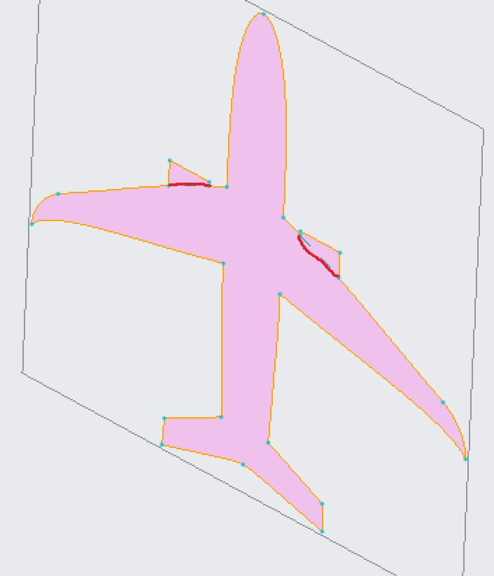

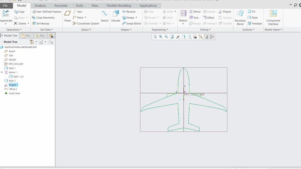

Hi all,
I'm trying to extrude a 2D image of an airplane that I created from complex curves in the Style tool. However, the extrude feature only seems to take sketches. I've tried workarounds with the offset, project, sweep tools, etc, but none have worked. Does anyone know how to extend this image in the normal direction and make a solid object?
Best answer by MartinHanak
I projected all your curves into section of Sketch feature and then deleted segments marked by red lines.
