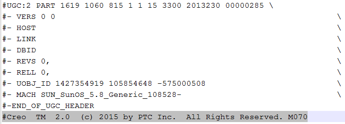

part mentioned in message "(part name) could not be retrieved":
  • can be corrupted -OR-
  • has been saved in newer software version
You can check software version if you open part file in Wordpad - see picture.
MH
