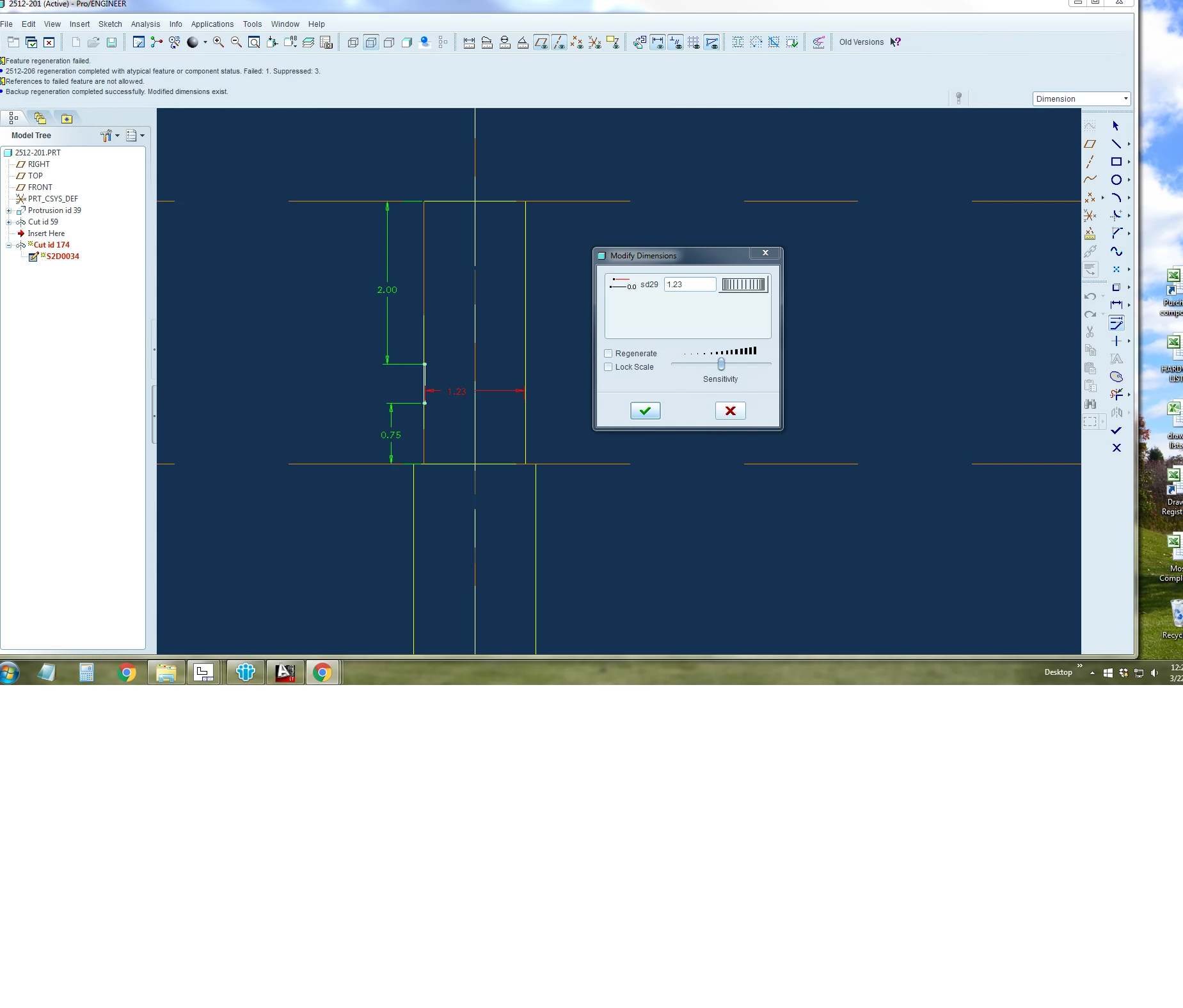

When I try to change a dimension of revolve diameter on "Cut id 174" from 1.22 to 1.23, Pro E show "some features failed to regenerate"
Need help to figure out the reason and fix it, thanks!
Bill
Best answer by StephenW
It's likely an accuracy issue.  Go to file - prepare - model properties - accuracy - change and adjust the accuracy to a smaller number.
StephenW
StephenW23-Emerald IIIAnswer
March 22, 2016
bxu1-VisitorAuthor
March 22, 2016
Stephen, you are right!
I changed accuracy from 0.002 to 0.0002, and the error gone. Thanks...
