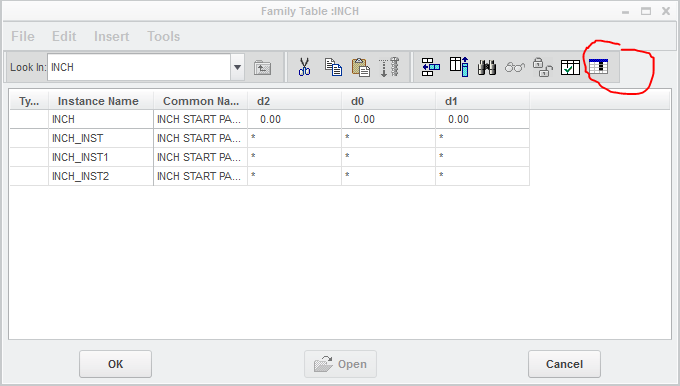

Yes You can.
Click on the icon highlighted and it opens the family table in excel where you can edit the values, save and close to reflect in Creo.
