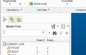

When I select to add a column, it brings up a dialog box, and then I have to go searching the model tree for the part I want to add.
My dilema is that I never worked on this assembly and I am not sure where a few parts are at and it has many sub-assemblies with sub-assemblies of their own going down a few levels and, from what I gather, there are more products here that are in similar composition. So if I am going to work on unfamiliar products, I was wondering if there was an easy way to add a Column and search for the component in the model tree.

There are a couple of issues here:
1. Searching an assembly knowing the component name. The easiest way to do this is using the search box at the top of the model tree.
Type the name of the component and click the binocular icon next to the search box

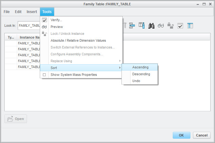

I've always been curious about how easy it would be to reorganize my family tables.  to be able to sort it to a nice & logical order as parts are added.
For instance, I have a family table of nuts.  The nuts are added as they were needed through the life of the company (and typically always at the end of the table).  So now, we have 20 or so nuts in the family table.  Problem is, is that they aren't nicely grouped.  the list jumps form the 1/2" to a #10 to a 1/4" to a #6, then a #8, then to a ..  you get the idea.  If I could grab the row & move it up or down or re-insert it, that would be nice..
September 23, 2015
Highlight the column that you want to sort by, then Tools, Sort, Ascending/Descending
