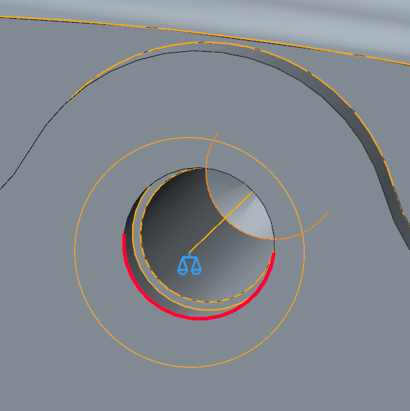

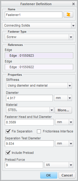

Here's one of the offending fasteners, with its details:
The surface highlighted to go with the error message is the face of the rear component, that the flange is clamped up against.

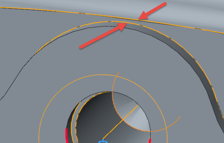

It might be having trouble with the fixed separation related to the location of the tangency of the rounded tab on the plate that's being fastened to the base part that has an Edge Round. You might try reducing the separation diameter.
Have you checked the simulation fastener diameter to make sure it's the same size as the minor diameter of the tapped hole or smaller?

Thanks Don!  It wasn't quite that - I tried reducing the separation diameter, and I tried adding a cut to avoid that narrow gap at the top of the flange; but eventually I tried increasing the separation diameter (to 11) and that worked.

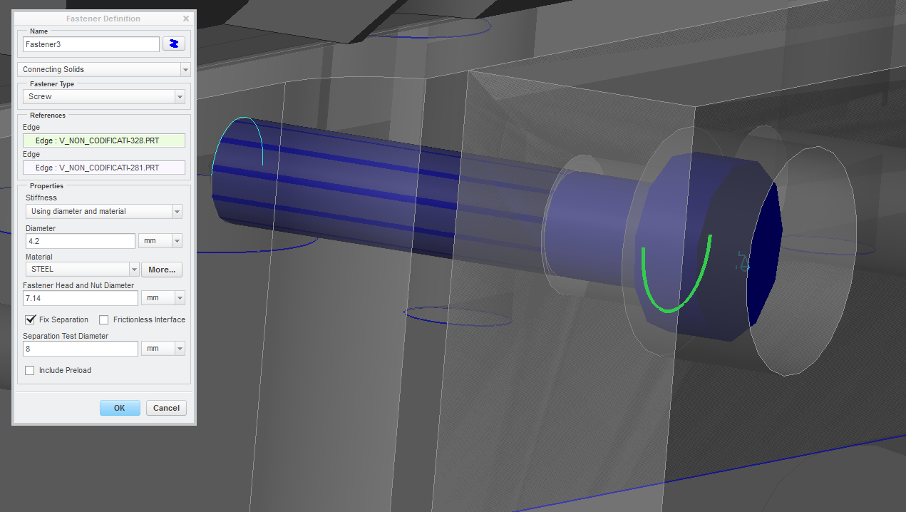

Hello!
I have the same problem
i I increase or decrease test diameter value (min.l 8 value), the mesh comand don't run with the same messagge in object

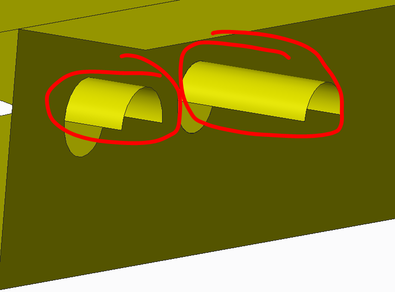

Maybe the problem is this?
With the command "Review Geometry", There are these surface... I think that is incorrect.
