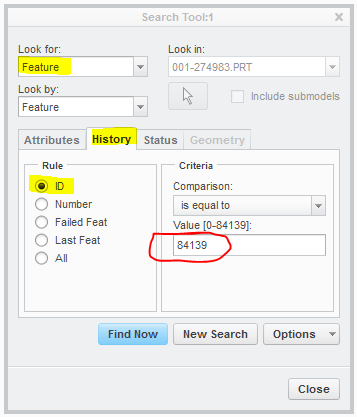

I got the errors
parent 4541 of feat 19231 missing or suppressed
parent 27346 of feat 27349 missing of suppressed
Is there a way to search the model tree for the Feature ID only? This would help with this and other issues when I only the the Feat ID vs the model name or description.
Best answer by TomU
Yes.  Look for "Feature" and on the "History" tab select "ID".

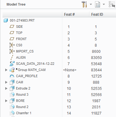

Also, both feature ID and feature number can be shown in the model tree.
TomU23-Emerald IVAnswer
October 16, 2015
jcolon1-VisitorAuthor
October 16, 2015
Why in God's green earth would they have that under history? Man, I never even thought of clicking history to select ID under feature. Thank you!
