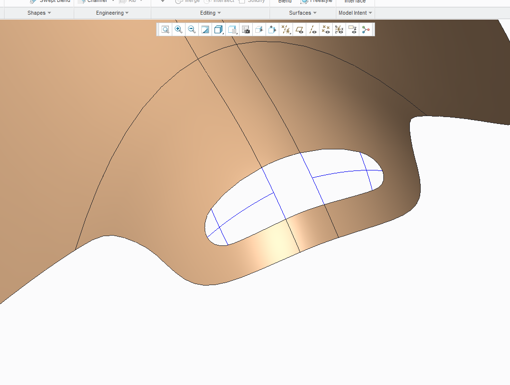

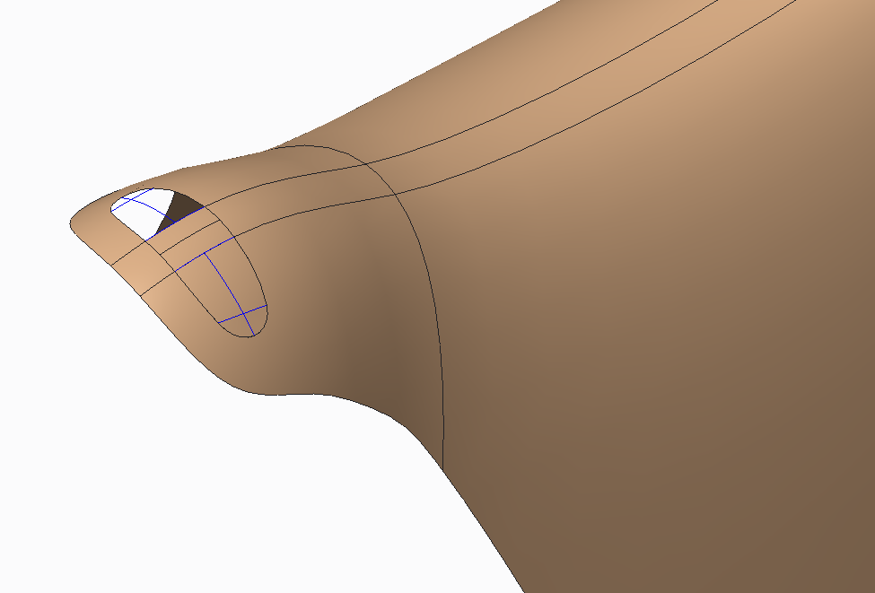

I am trying to fill a hole on a complex surface.  I use curves to chop it up and boundary blends to fill it in.  However the tangencies are not perfect and I can still see a small seam.  Any suggestions would help.
Best answer by psobejko
Well, that's just a starting point.  At least it fills in part of your hole.  After you trim away at this copy and re-merge the the original quilt, you get kinda close:

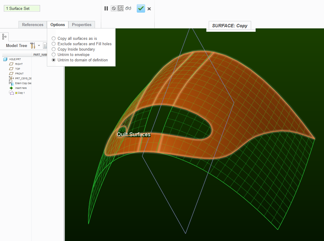

Did you try selecting the quilt, and doing a copy and paste with the "untrim" boundary option?
This thread discusses similar "reverse-engineering" effort:
Is there a way to fill the hole?

I tried that and it doesn't give me the results I need. I lose the profile and I get overlap with the existing surfaces.
psobejko1-VisitorAnswer
February 24, 2017

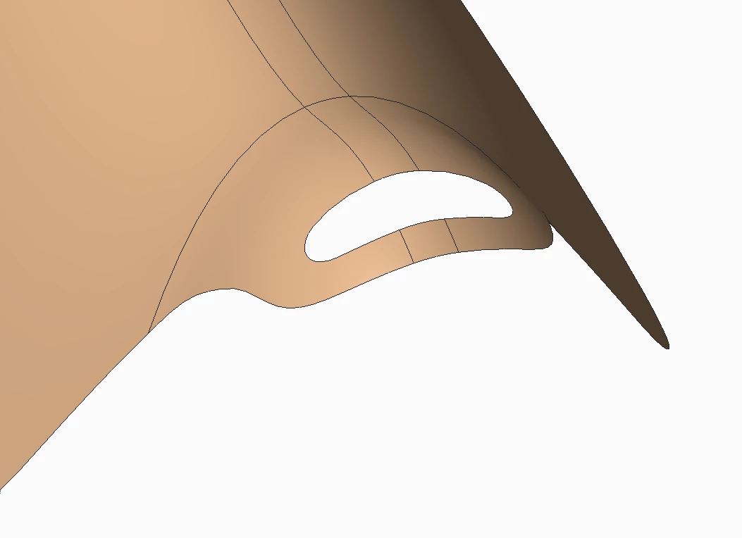

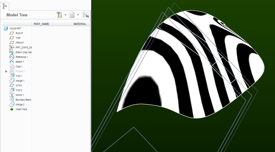

Here is how is stitched it together
February 24, 2017

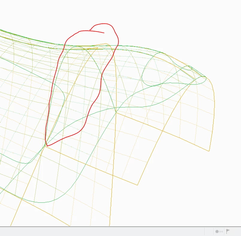

This might be due to issues with the source model. I'm seeing some wonky intersections on the copy geom:
February 24, 2017
Yeah, after trimming out the center section, I was able to patch it pretty easily (pardon the quick and dirty modeling).
