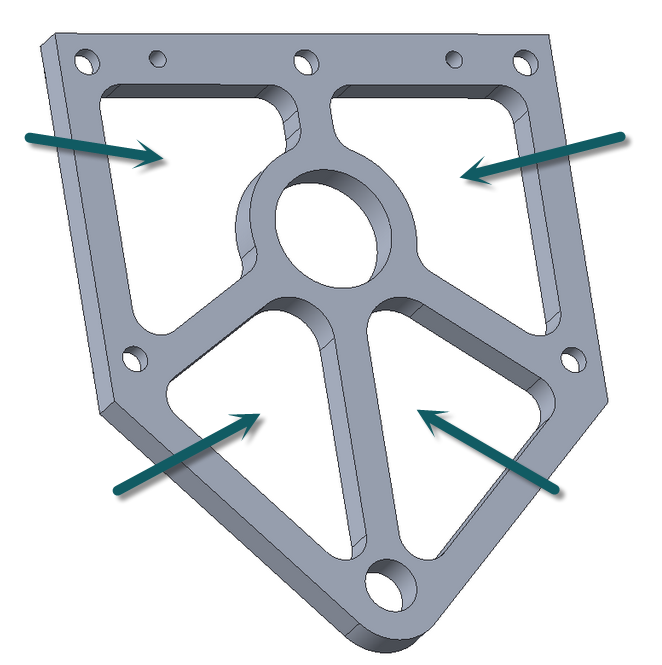

Hello, I am a student and new to PTC Creo parametric and design.
I have a part with four large holes around the center I would simply like to fill in. I have not been able to do that so far and any step by step instructions would be appreciated. Below is the part with the four gaps I want to fill in.
Thank you very much and I hope we can solve this problem!

Do you want to remove areas marked in image?

June 15, 2015
Check attached video.
Activate Flexible Modeling > Select Side surface in cut area > Select Cut in Shape surface selecting > Remove
June 15, 2015
Yes, those are the holes and thank you very much! Earlier I had been trying to work with datum planes but this is awesome!

June 15, 2015
Interesting.  Will that work for NON-planar cuts?  If not, it'd be simpler to add a single extrude feature.
