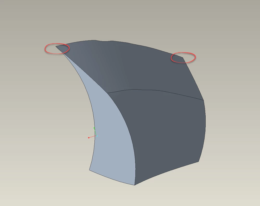

This knife edge geometry is likely a problem. Try shelling out your model and then apply the lattice following the method that @Dale_Rosema posted.
Garbean10-MarbleAuthor
Thank you for your input. The Knife edge is crucial in this design and can not be avoided. I have, however, tried  the above mentioned method on a similar geometry that does not contain a knife edge without success. I assume this is the limits of the complex calculation required behind creating these lattices.

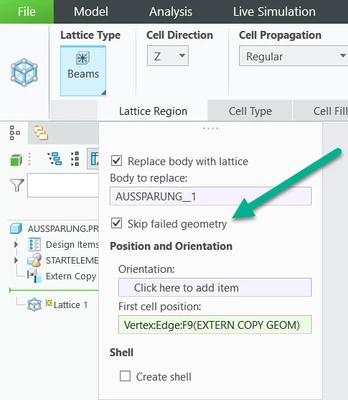

I do not have a lot of experience with lattice structures, but could you initially stop short of the knife edge and after adding the lattices, add the knife edge back to the part? Just a suggestion.
Is this checked in the cell's settings?

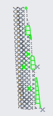

A good idea, thank you for your reply. I have tried with the box checked and it ends the process without an error now. However, the result is not statisfying. Multiple lattices are missing.
I am coming to the conclusion, that this is a program limitation and the task is too complex to calculate because of the winding surfaces of the target body.

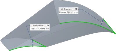

@tbraxton  drew your attention to the fact that you have knife-edge geometry, and you are drawing a (wrong) conclusion about Creo's capabilities.

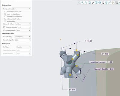

Notice that you're attempting to fit a 3x3x3 mm grid into a space that can only hold 1.8-2.2 mm.
Furthermore, I don't understand why the lattice is required to reach the blade's tip rather than remaining a solid that maintains the entire geometry. Even assuming this is the design intent, I'm not sure how you'd print such a part with such a thick lattice, let alone the issues that would arise from adding the ball at the cell nodes. Judging by the geometry, this appears to be an academic activity.
