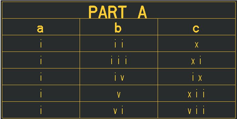

Hi All,
Need your help to resolve my problem related to Repeat region. Request you to read my problem description carefully and provide solution as I am stuck in my project because of this.
Problem Description : I have created assembly drawing. Assembly has 5 components in it. All components are instances of their generic parts and instances are selected through "Lookup instance". Each generic components have large number of instances. Each generic has family table with 3 Parameter columns, value of which is used to compare and select appropriate instance to be used in assembly. For example, let us say, these three parameters are "a","b" & "c". Each parameter/column has some repetitive values. I want to create a repeat region table such that, the resultant table display a list of instances, which has same value of parameter "a". (Refer below image for required outcome).
It will be OK, if we do not show column for "b" and "c", but table should filter out the instances with same values of parameter "a".
Thanks in advance.
Bhavin

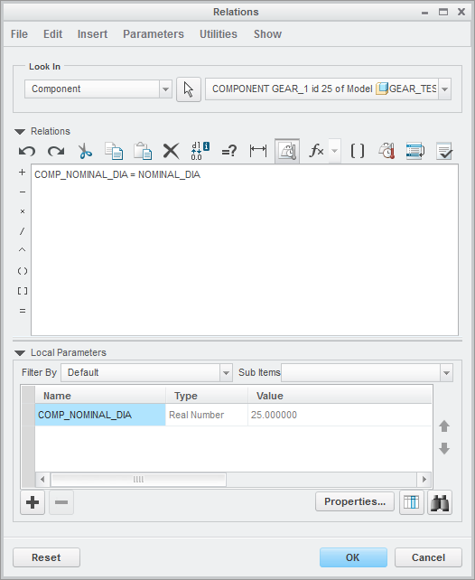

I think I may have a possible workaround.  For this to work, your repeat region needs to be of the entire assembly, not just one model's family table (although you could certainly filter it so it only displays data from one model family.)
Repeat region relations can't directly read assembly level parameters, but they can read component parameters.  You could create a component level parameter that reflects the assembly value (ex. NOMINAL_DIA).  Do this for each instance used.

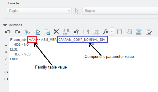

Now go the repeat region, add this component parameter, and then use it to set the value of a repeat region parameter.
Finally, add a repeat region filter based on the value of the repeat region parameter "HIDE".
After doing this, I can change the value of the assembly level parameter "NOMINAL_DIA", and immediately the repeat region table will update to only show instance where "AAA" equals it.  I believe this is what you're trying to accomplish.

Hi Martin,
Thanks for providing Links.
However, My question was requesting for one step ahead of that. I am looking to set the "Filter" and/or "Relation" in Repeat Region Table, so that my table display only instances, having particular value of particular parameter. Not only that, but also I need that parameter value should be fetched from assembly.
For example, if somehow I can execute following expression, may serve the purpose.
&fam.inst.param.value==NOMINAL_DIA
Where, NOMINAL_DIA is the parameter in assembly in which Family instance is used.
In short, we need to associate part parameter with assembly parameter in (Repeat) Region Context.
It would be great, if you can provide some solution(s) to this.
