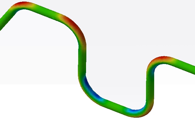

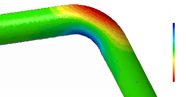

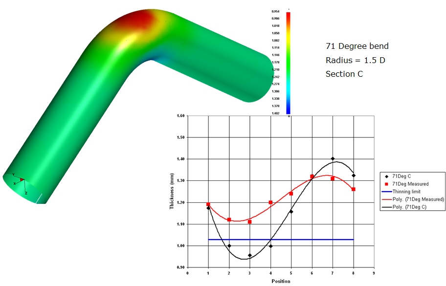

With FASTBLANK for Creo, we expect the pipe to have a 0.100" slit in it to allow the software to "open-up" the pipe. If you can add this to your Creo model I'll develop the blank for you. I'll need to know your material properties to be accurate.
Additionally, FormingSuite is able to conduct a formability study on tube bending.

This is all probaly overkill for your question, but here is some information anyway.
