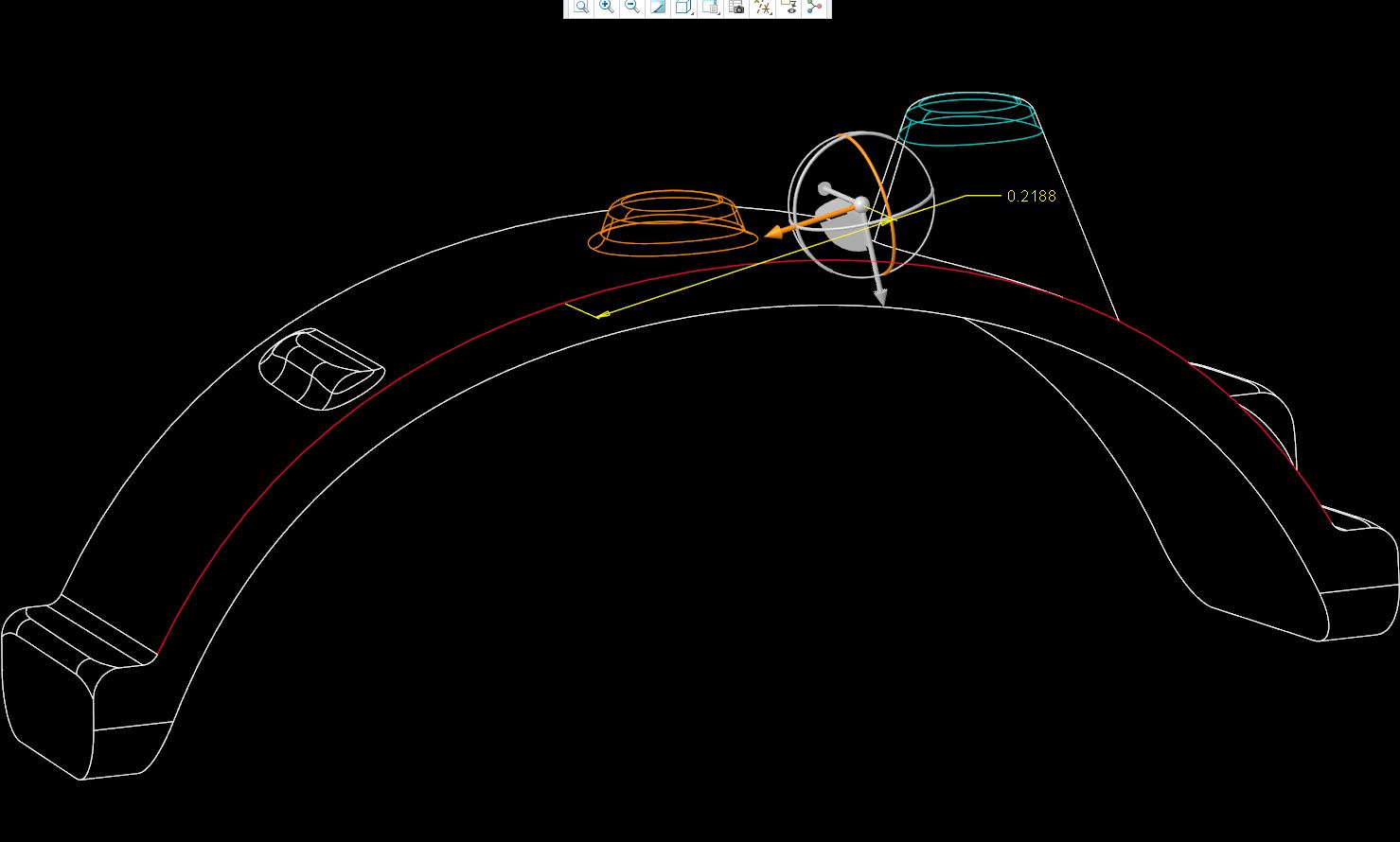

In Flexible Modeling, is there a way to move a boss along a curve? When I place the dragger on a curved edge it only moves the boss in a linear direction.
I am moving the boss on top of this part (highlighted in red) and placed the dragger on the curve (highlighted in red). You can see the move is linear. Is there a way to move this boss along this curve an have the boss remain normal to the surface as in it's start position?

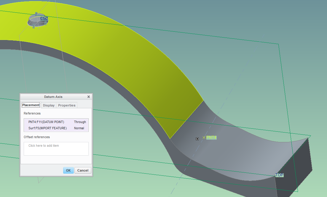

This has been a very interesting and educational exercise; for example, a strange thing is revealed if the PNT4 point that is used to define the A_4 axis is moved off the surface to which that axis is normal:
When you then edit the definition of this A_4 axis, you will see that now the axis is normal to new surface (not the original yellow one) ???
Funny thing is if you tried the above datum creation methods with quilts instead of surfaces, then it doesn't work at all - for you cannot select quilts" when defining axes.
This is strange, because you can define a datum point that lies on a quilt...  Anyway, learn something quirky everyday with this software.

I would try building the boss with respect to a length ratio point that can be dragged along the curve.  The axis of the boss would remain normal to the surface at the location of the length ratio point, a sketching plane placed normal to the axis would update, etc.
I hope this helps and provides you with a solution.

Thanks for your response and the model you sent. I understand your resolution if I am building the boss. However, this is an imported model and I am trying to use the Flexible Modeling functionality to move the boss along the curved surface by placing my dragger on the curve.
Dan

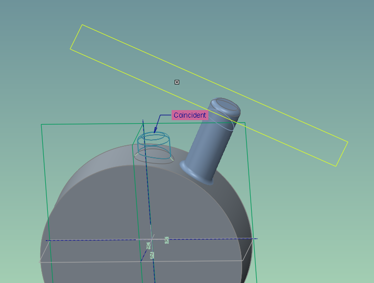

Use "by constraint" mode of the move tool.
I haven't been able to do anything strongly parametric, but try this as a jumping-off point:
Set up a datum plane (let's call it "DTM1") which coincides with the upper circular surface of the new boss.
then "move" the existing boss and use "coincident" constraint between the upper circular surface and DTM1.
The tool will report that STATUS is "partially constrained".  But the previewed geometry should be in the right spot:
At this point, add one more constraint - the "Fix" constraint and you should be able to go.
Bad thing is that if you redefine DTM1, the model will not regenerate correctly - until you redefine the "move" feature, remove the "fix" constraint, and then re-apply it.

These all seem to work fine for a surface that is a true diameter. Let's go a step further and say the surface we are moving the boss on is not a diameter, but some random shape. This where the original post came from. Is there a way to move this boss along the curve or is this an enhancement request waiting to happen?
Thanks again guys.
Dan
September 18, 2015
I can only say that the flexible move should work in general - the key is to locate the new CSYS appropriately, and you have lot of datum features to do that.
The one that is used in the example attached: datum point on a surface, then an axis through this point and normal to the surface.  Then base the new CSYS on the point / axis above.
Then flexible move by coincident constraint.

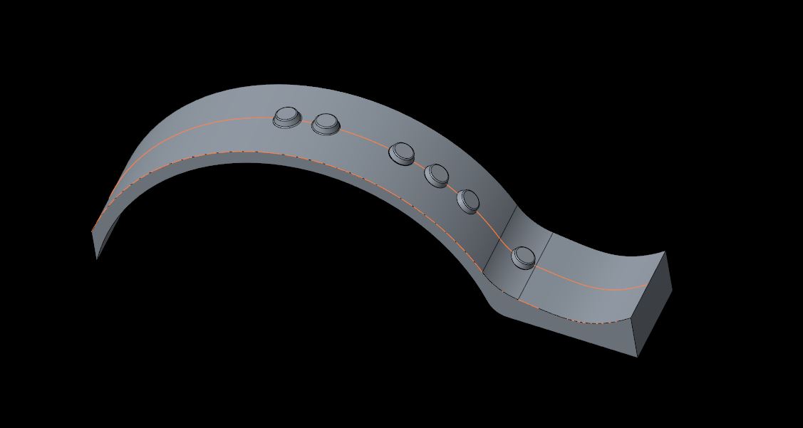

September 21, 2015
Guys,
Mahesh Sharma, an AE from PTC has been watching this post and he came up with using a flexible pattern to copy the feature over.
It works most of the way along the part, but doesn't create the feature on the added extrusion.
Take a look.
