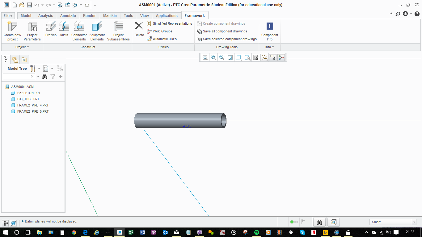

Does anyone have an idea why when I am trying to use framework, this happens. The tube is suppose to go the whole length but doesn't. Very frustrated and have been trying to figure out why it does this for two days now. Any help would be really appreciated!

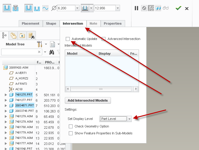

When in the assembly, select the Hole creation tool in the model tab, place the hole as desired. Then go to the intersection tab, unselect the automatic update, change display level to PART LEVEL.
