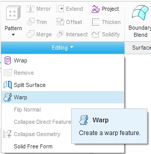

I've used a tool (a long time ago) to make some deformations on a part
(extend, bend, twist.).
I can't find it anymore in Creo2.
It's not seems to be Flexible neither freeform.
Can someone tell me is it available anymore?

I think you are looking for the warp feature. It's under the modeling tab. Modeling -> Editing Group -> Drop down -> Warp

You are looking for the Warp feature. Select Model, Editing, Warp in the ribbon menu

That's it.
Thanks to everybody have answered.
The Wrap feature is what I was looking for.
(Didn't used it since a long time.)
As we can just apply it on a part, is there any trick to apply the same wrap
deformation on several parts of an assembly?
(Perhaps using a skeleton but how to.?)
