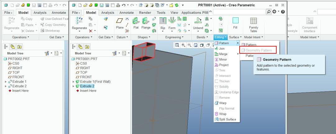

Is there any Specific reason why Geometry pattern is grade-out in the sheet metal modelling ? ,we have this option in the Solid part modelling.
It is a simple geometry in which only a surfaces will be created to provide a lightweight feature to the model. This geometry pattern can be used for the visualization purpose, The time taken by the model to regenerate is very less compare to normal pattern

Here is the SPR.  Looks like it will be a while before the functionality is available

It probably won't happen since unfolds require regeneration of each feature in some scenarios.
