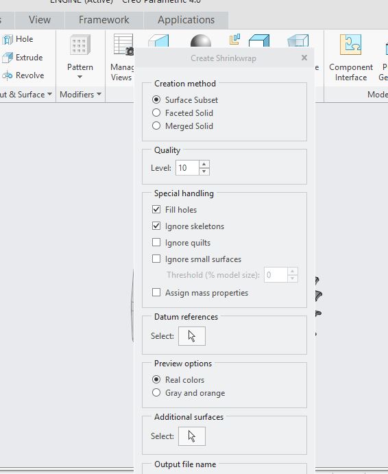

Shrinkwrap.JPGfile> save as > shrinkwrap> shrink export window will appear increase quality level or use merged solid and also increase quality ..I think it can solve your problem.
