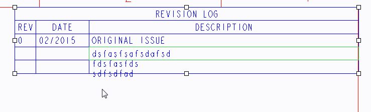

I developed a format that I like to use when creating drawings. It has a repeat region for the BOM, a rev box, etc. Well, lets say I create a drawing, but i want to go back and change something on the frm file. How do I get it to update in the drw??
Since this is a small part of my job that i do every now and then, in the past I have just made a "new" drawing, and transferred everything over.. But that is getting really old.
I have tried update draft, update sheets, etc.

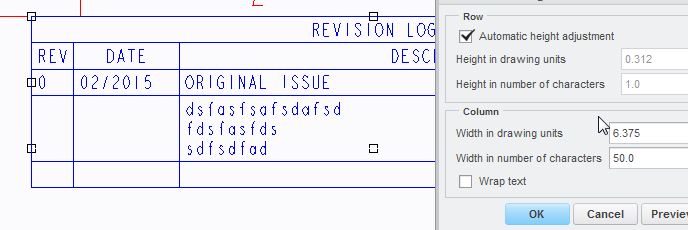

In particular my current problem is my "Revision log" box is a static table 3 wide, 5 high. Rev 0 was just "original issue". Now I am doing rev1, and the comments have to take 3 lines. So in the drw if I do it, comment spans the next 3 lines. If I set the row height to automatic, it resizes the row properly, until i hit ok and the dialog box closes, then I suspect the frm details take over and I have my single row height grid lines, but a 3 line height field.
I tried going back into the frm and setting the row height to automatic, but since i cant get the frm to update in the existing drawing, I cant get it to take.
thanks in advance.

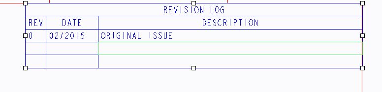

My starting point in the drawing:
Add 3 lines of jibberish to the highlighted cell.

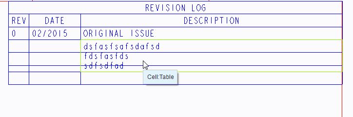

Select cell, set to auto height, everything looks proper..
Hit ok, and it the grid lines follow the original format, new grid line for the resized cell, etc..
