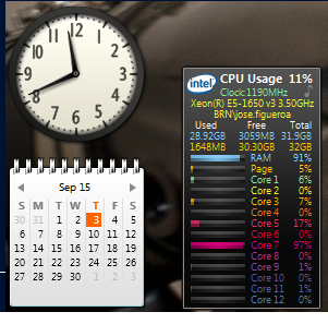

So I just got a new computer that is so hot, it can cook a chicken.
http://www.amazon.com/Lenovo-4351E1U-Thinkstation-E5-1650-6-core/dp/B00FE2LEIG/ref=sr_1_1?ie=UTF8&qid=1440772396&sr=8-1&keywords=lenovo+4351
Changes to that system are... I have 32 gig of ram ( Soon to go to 64 ) and a A 250 gig solid state hard drive running Windows 7 pro.
6 corers and 12 separate threads!
I am using 12% of the CPU and almost 100% of the ram for an assembly.
Why is Creo not using all my CPU availability?

Most of Creo uses 1 core.

Jose,
because Creo is single threaded in most operations, the highest overall use of the processor is 100% / number of cores, this means 100 / 12 = 8.3 %
To get quicker response, you need the computer with overclocked processor. Number of cores is not important.

In fairness, your E5-1650 v3 (not v2 as listed in Amazon) scores reasonably well.  Note though that it has six physical cores, not 12 - and it may run cooler (though not noticeably faster) if you disable hyperthreading in the BIOS.
Also, in your screenshot you're using only a fraction of the RAM too - but you'd need a pretty big assembly to use up 32 GB.  What do you need 64 GB for?
(edit) Oh hang on, I don't understand the two values each for 'used' and 'free'.  Is the second one the page file?  If so then yes, you clearly need more memory!

As suggested by Jonathan, turn off hyperthreading in BIOS, that will boost performance with Creo abit.

By disabling HT, you will see a higher *reported* CPU usage as Windows will now think you have only 6 cores instead of 12.
In practice, it's reckoned that real performance advantage when running many threads with HT is actually only about 1.3×, not 2×, but that's irrelevant with a single-threaded program such as Creo.
In theory, disabling HT could make a tiny improvement for single thread performance by avoiding switching overheads and sharing of resources, but in practice I don't think you would notice it, or possibly even measure it.  (HT is supposed to make use of small periods of idle time on each core, while it's waiting for other things to happen, so you don't get that time back by disabling it.)
In my experience (and supported by some internet searches) the CPU will actually run cooler (certainly at idle) with HT disabled:

Are you sure Creo is using all the RAM?  Might want to look at Task Manager. (Right click in the task bar.)  Look for the xtop.exe process.
If it really is, what are you opening?!?!  I've opened what I thought were pretty large assemblies and never got higher than maybe 7 or 8 GB of actual RAM usage.
September 4, 2015
That is a lot of RAM usage, although I have opened what I thought were small assemblies and I have used 12-17gig of memory. But my problem SEEMS to be video card memory. when it maxes out everything slows down.
