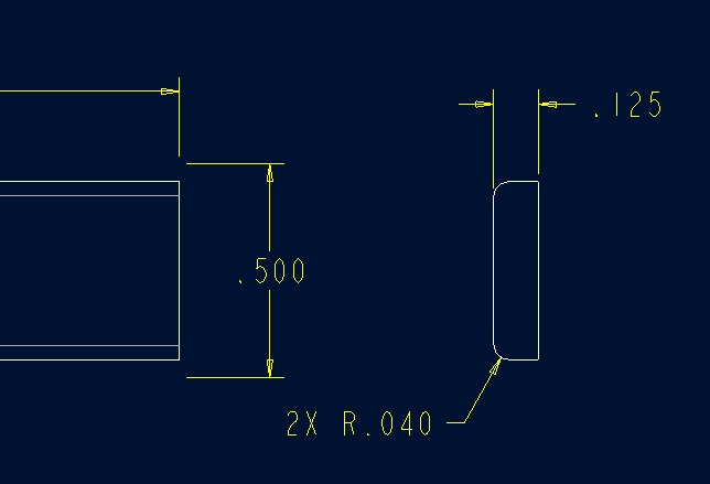

We recently had a server crash and lately, Pro5/Creo has acting a little off.

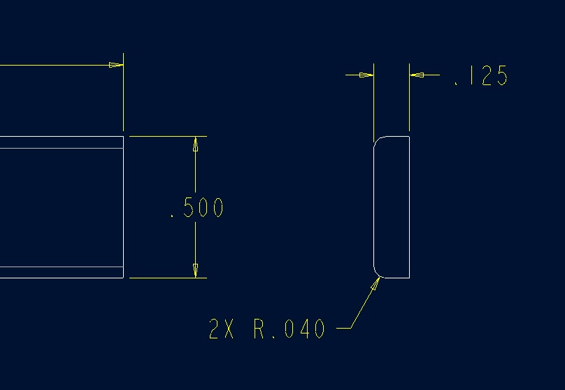

I updated a simple dimension on a part. (.500 was .600 ) and the drawing "half" updated as shown below.
I did a regen - didn't work. Did a regen on the instance in the family table - nothing.
Other things tried:
Regen on generic
Verify all instances in generic
Saved the model
Saved the drawing
Closed everything and the opened it again.
Finally I got all the way out of the Pro5/Creo and reopened the software, drawing and model and it was correct.
Finally it was correct.
Any thoughts as to why this may be happening? Nothing changed with the graphics card recently.
No new drivers were downloaded that I am aware of (is there a good way to check this?)
Thanks, Dale

In this case, it is not regenning correctly, but open correctly later on.
