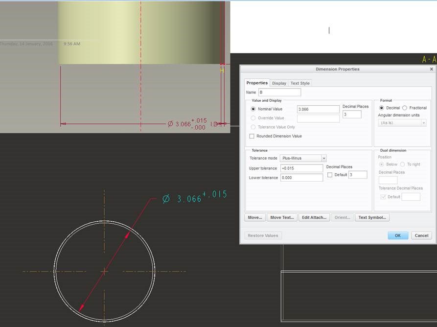

Has anyone seen this issue on Creo 3 M060
  • January 14, 2016
  • 2 replies
  • 1303 views
When setting the lower tolerance of a dimension to 0.000 it disappears.  It is fine in the model.  This happens for created or shown dimensions.
Best answer by Mahesh_Sharma
Wayne,
Try setting drawing option blank_zero_tolerance as no.
Mahesh_Sharma
22-Sapphire I
January 14, 2016
Wayne,
January 14, 2016
in your dtl file, you need to set
blank_zero_tolerance NO
don't forget to regen
