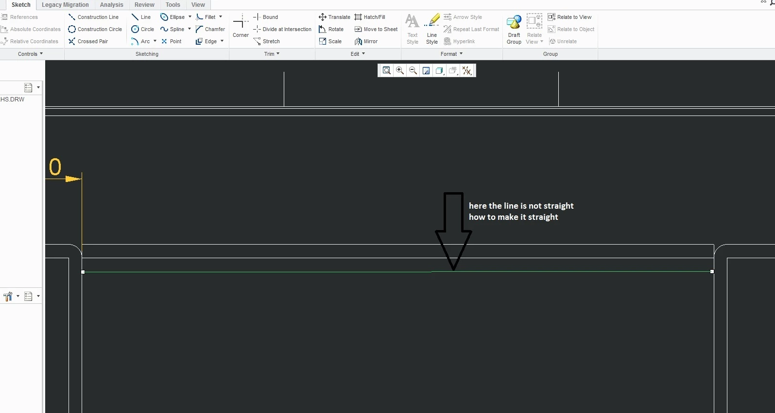

Hi everyone,
1.How to draw a stright line In creo drawing mode from sketch tab
what i had tried
i have done hatching in creo drawing with adding section in the model and show it in the drawing
now my question is i want hatch the solid part in drawing without adding section in the model in an assembly drwaing (just like in autocad) so i tried one thing in creo drawing go to sketch>select line > draw line where you need to be hatched > then select hatch fill command. but while drawing the line the line does not take any refrence then when i try to draw a straight line it draws with an angle and the loop does not complete so hatch /fill command does not work. how to solve this
any suggestions will be very helpfull

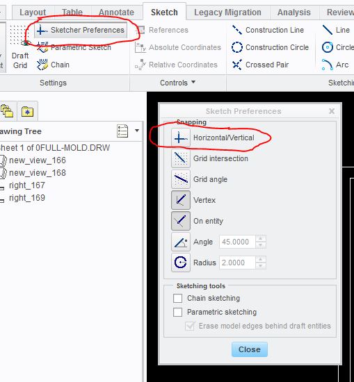

Best answer by Inoram
One way to get straight lines.

Inoram14-AlexandriteAnswer
January 23, 2014
January 23, 2014
if anyone knows how to default this on, that would be great.

Right click and input 0 degree in it.
June 5, 2015
use line,not sketch preference.
June 5, 2015
Or you can use cosmetic sketch in 3D model to make the hatch as well.
June 5, 2015
Or Sketch feature, too.
