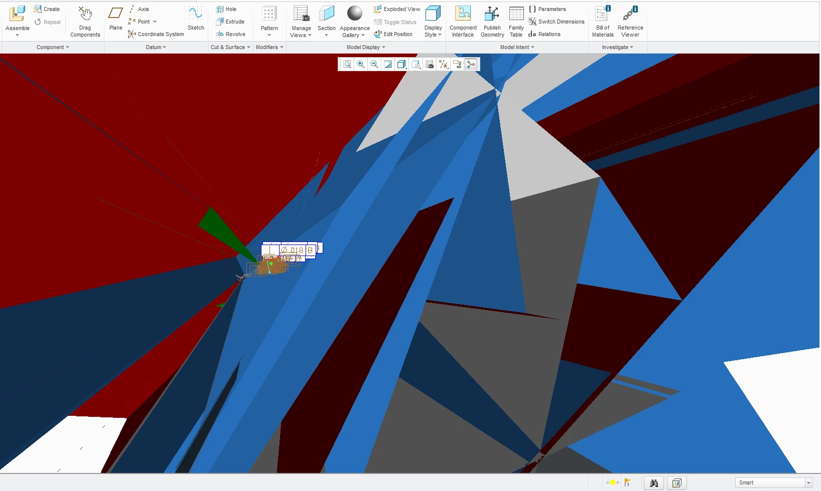

Hi all, I recently upgraded to creo 3.0 from creo 1.0. I have some complex assemblies that I use to be able to view, but now that I load the model, I get an explosion of color. I'm confused by this. Any recommendations on how to fix this would be much appreciated. Thanks for your time.
Best answer by Inoram
It appears your driver is really old (going on 5 years?) since the latest drivers appear to be in the 14 range (versus your 8). So you probably need to update your driver.
Changing your "graphics" to "win32_gdi" wasn't really the fix. That was the test to see if your graphics card/drivers were the issue. Now you can run on win32_gdi if you want, but it's not using your video card fully and everything may run slower.

Have you considered selling it as new age art?
Do you have perspective turned on?
Try the setting: graphics win32_gdi just to get a baseline.
March 5, 2015
Are you making a bid???
I don't know how to check if perspective is on, but I doubt it, because some of my simpler models do display correctly.
I can't figure out how to set win32_gdi either. It doesn't show up in the config.pro list.
March 5, 2015
What graphics card and driver version?
