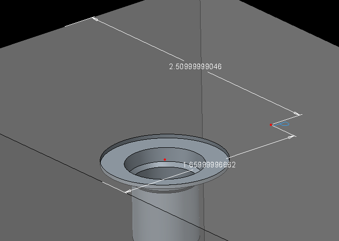

Creo2 M140... I am having a problem finding a way to display only 3 decimal places in the model. Right now it is coming in as 12 decimal places. I have changed the default_dec_places to a value of 3 with no luck. I also tried the method of changing the dual_dimensioning to secondary with the dual_digits_diff set to -1. Still no luck. Help would be greatly appreciated.

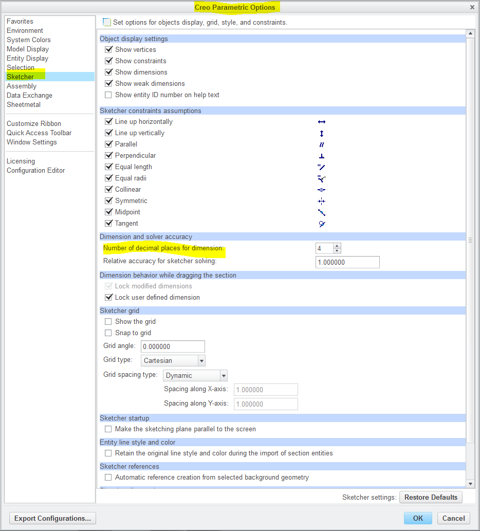

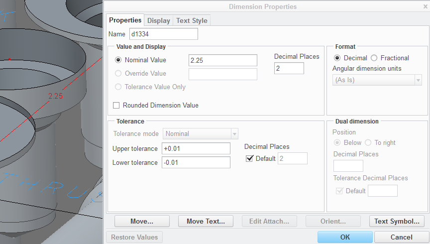

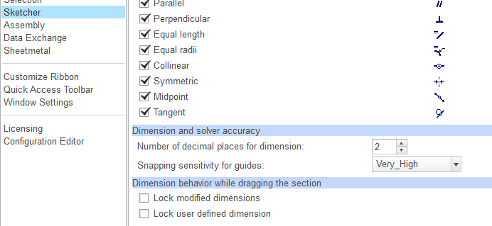

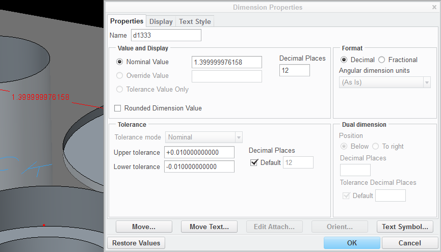

Ok, this is very odd. Below is a series of screen shots. The dimension properties are taken from the same node. As you can see the 1.39... is set at 12 decimal places and the 2.25 is set at 2 decimal places and both have the default box checked. Same node on the same part. The 1.39... is a horizontal dim and the 2.25 is the vertical dim. Below these are shots of my sketcher preferences and config pro setting. It seems like there is a conflict somewhere.

That was the last part of my comment... Creo loves to give itself an edge by taking away .00000000001 from a value so it seems to avoid coincidence... or whatever reason it can't manage absolute values.
But for some reason, your rounded dimension value checkbox is turned off. I am not sure if there is a config.pro setting for this. It could have come from a legacy start part or something. But yes, you will find a lot of dimensions not quite hit that rounded number when creating geometry. Some just toggle on their own regardless of what you input. Somehow the software considers this "noise".
Never the less, without the rounded dimension value checked, the decimal places will be whatever the real value is.
Personally I keep all values to 4 places and in a drawing, I change them to 2 or 3 . This lets me use fractional values and confirm their true data in the system, and I make the determination required on the drawing. .1875, for instance is a real value for 3/16. I can determine if I want the drawing to show .188 and if I want to update the value to .188 or let is remain .1875 in the model to show intent. It's a tightrope, but this is the best for my way of working.
