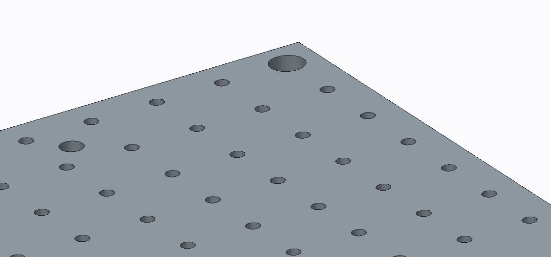

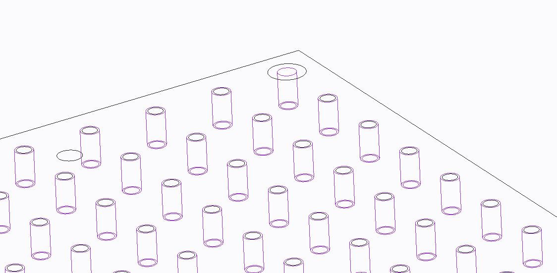

I've created a perf-board (some might call it a bread-board), but when I try to incorporate it in my final drawing, what SHOULD be hidden lines are not hidden.  Visually, it is unusable.
When I go back to the model, it ALSO fails the "hidden lines" routine
It SHOULD look like this (shaded works fine):
But instead it looks like this ("No Hidden" fails):
I've checked the model tree.  There are no errors indicated.  I've regenerated it, without any errors popping up--except the obvious, visual one!  All lights are "green."
Any ideas?  I have bunches of objects assembled to it up the line; I REALLY don't want to have to recreate the perf-board.

ssywak1-VisitorAuthor
December 7, 2016
Dale, that was exactly it!  Cosmetic threads!
I edited the initial hole, which was threaded, and UNCHECKED the box "Include thread surface" under "Shape."
And it all resolved.

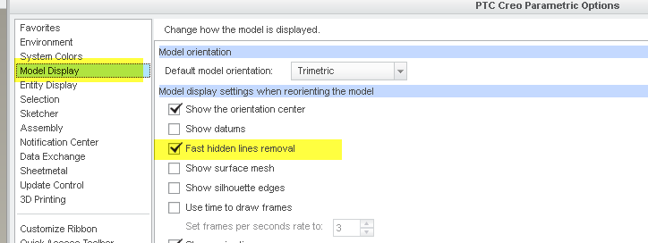

My response was specifically drawing related. I think you are talking about the model.
On quick way is to turn on the fast hidden line removal option.
Another way is to add your feature to a layer and turn off the layer.
December 7, 2016
FYI, Fast HLR sometimes causes other issues along the way but I can't remember exactly what they were.
