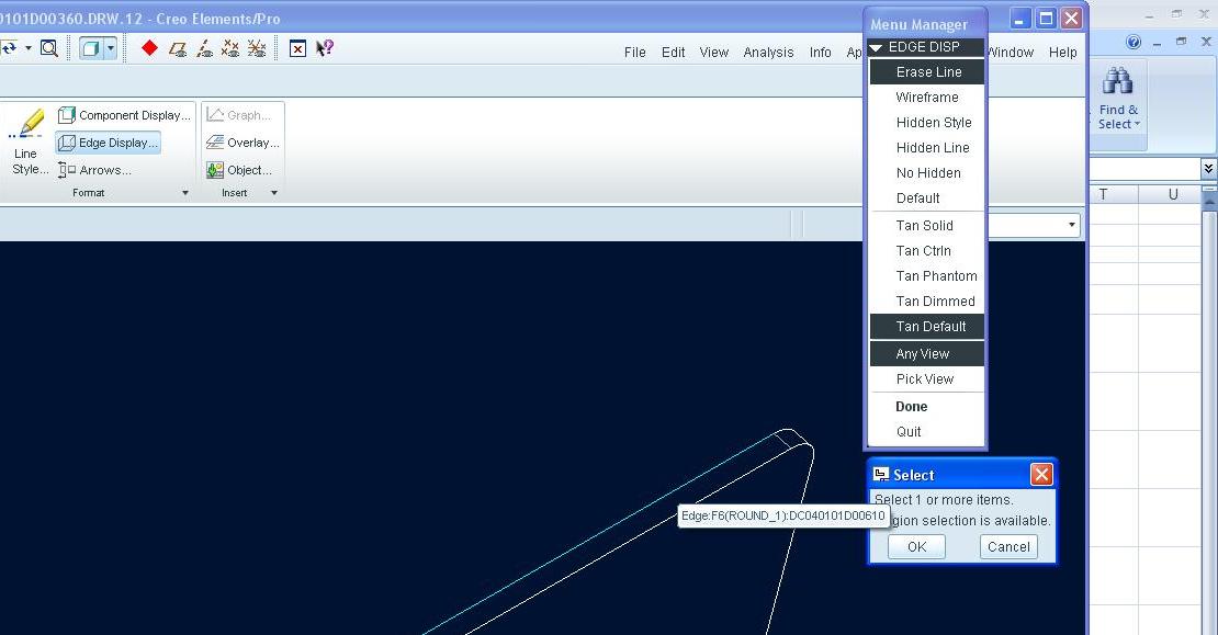

Thi has to be the least intuitve thing in Pro/E. Could someone please explain how to hide, say, one edge of an isometric cube in a drawing?

There is an option to control edge display
Edge display> Erase Line> Select line
I hope this will help you

Can anyone point me to where to find this command in Creo 2.1? Thanks!
StephenW
June 8, 2015
In the layout tab, select edge display, then the menus are the same as above.
