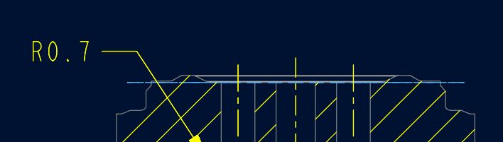

I was wondering if there was a way to show a model sketch in a particular view, but hide it in the others. I've been creating sketches in my models to later show bolt circles, gage points, etc., in my detail drawings, but I don't know how to control which views they are visible in. I always get what you see below.
Is there a better way of doing this?

Mohan,
If I remember correctly, I would create a layer in my model and put the sketch on that layer.  Then in the drawing, I would go into each view and either hide or show the layer (use the layer tree in both the model and drawing to do this).  There's probably a better way to do this, but this is the only way I ever figured out.
Matt

Matt,
use Help and study an effect of following drawing configuration options:
draw_layer_overrides_model YES
ignore_model_layer_status YES
Martin Hanak

Thanks Martin,
I didn't find too much on the config options. I did figure out how to hide specific layers in different views, so that fixed my problem I think. I really need a training course in Creo.
