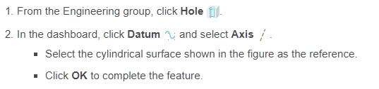

Can someone help me with the attached snippet from the CREO 3.0 training? When I click "Hole" from the Engineering group, I don't see "Datum" or "Axis". Is it on a different tab?

The "Datum" group is on the far right side of the dashboard. By default it's minimized and looks like this:
But it may also be ungrouped and then looks like this:
I don't think you may hide it completely, but if you don't have it, you may always go back from Hole tab to Model tab and the Datums tools will still be available for use.
