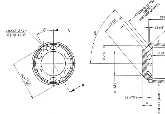

Hi Folks
How would i model these 6 holes. The are located on the taper and driven by 50 deg and12.8 TYP dimension where the latter dimis reference from an offset datum section A. The hole &sweepfeature wont let me dimension from different orientations which is the casehere. See attached
thanks

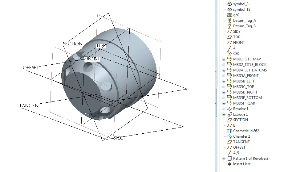

Folks
I received some good input but most ignored the two dimensions at stake here, 12.8 offsetand 50 deg. It might been my fault so i am attaching the work completed so far. I created datum tangent to the slope and normal to the section datum. Then offset this datum (named tangent) to a distance of 12.8. Then create axis that intersetcs through theoffset and front datums.But apparently, the 50 deg will convert to a mean dim of 44.1 deg. And it cant be shown on the same sectionA of the drawing. Feel free to question the drawing dimitself, they are from a contractor.
