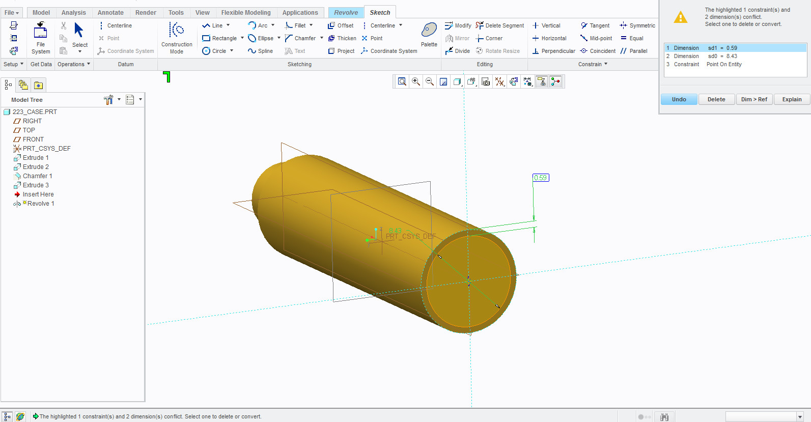

I am quite new to creo parametric 2.0, and I am making a 5.56mm bullet case. However, to make the rim, I am making a circle for the extractor to hold onto. However, when I use the "Normal" dimension tool, I can't create a dimension to distance it from the surface I am creating the circle on, it just comes up with the dimensions of the circle itself, I don't want that. Can any experts help me here?

Oct 11, 2014 5:40 PM UTC
Picture please?

Oct 12, 2014 3:07 PM UTC
If I understand correctly, you just have to delete the dimension of 8.43 because it´s conflicting with your pretended dimension of 0.59, and that´s all.

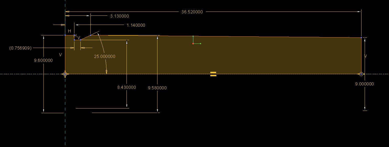

Oct 11, 2014 6:29 PM UTC
I tend to prefer revolve over extrude for cylindircal profiles other than a straight cylinder.
Oct 12, 2014 10:35 AM UTC
I'm currently attempting that now, thanks. However, there still seems to be problems. I've used revolve before, so I know how it works, but I do not know how to use it for this. I will continue to experiment though, and this is all this is really, an experiment.
Oct 12, 2014 5:32 PM UTC
I think you will find what you wanted orginally in the Blend feature. This allows you to define offsets between sketches.
You can use taper in extrude but it only takes angle references. You would have to calculate the taper angle to get the resulting diameter.
I am assuming you are trying to resolve the 9.58 to 9.0 dimension.
