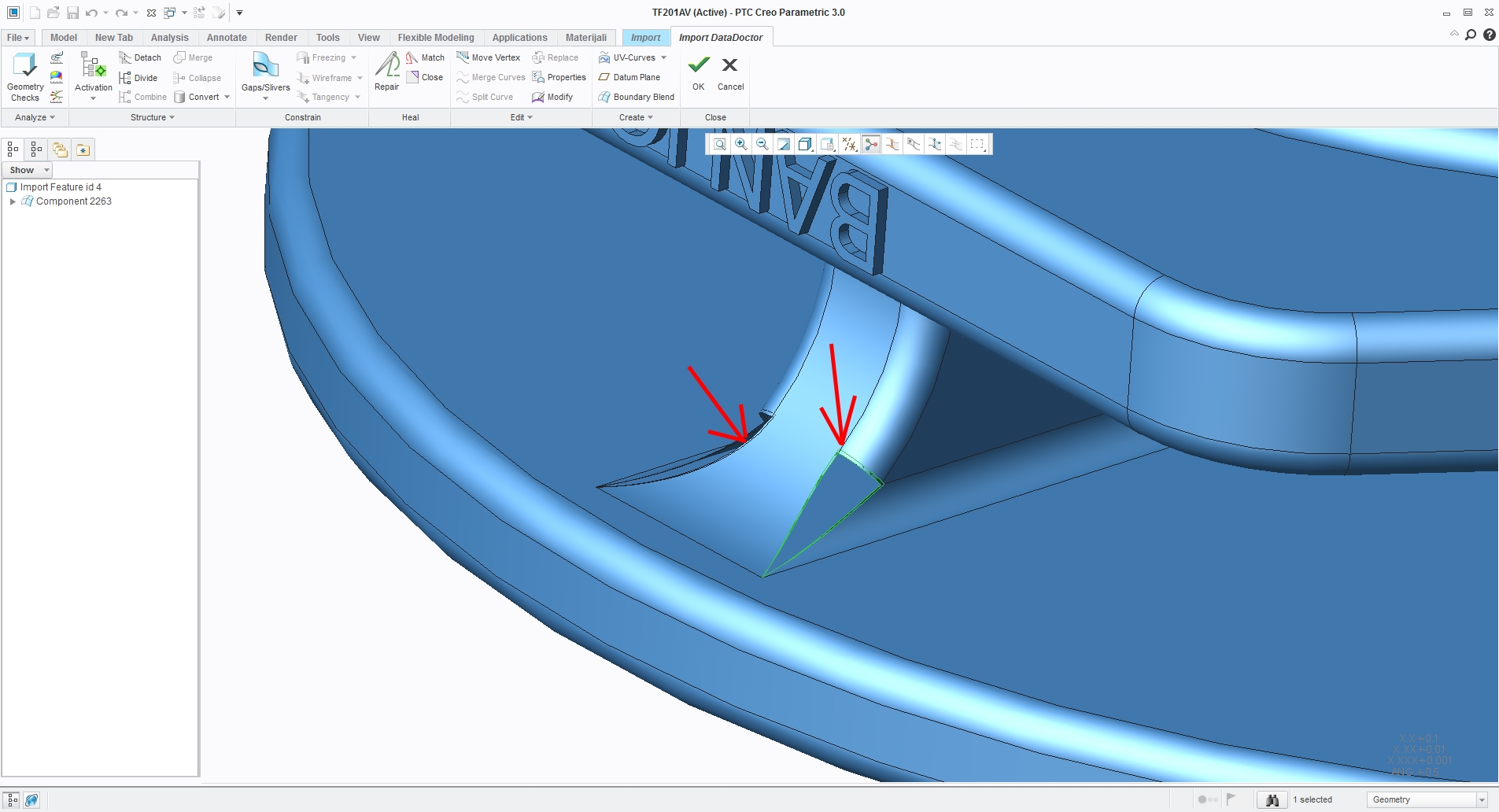

I Have a PRT that is only surfaces, I would like to Know If are there a way to change IT to Solid PRT.
I have Added the file, and waiting that somebody to help me with this ISSUE.

Another option here is repairing the geometry using IDD. With in IDD you can delete surface, create a new surface, fill the gap and close entities. These steps will not create any additional features in Model tree.
Check attached video for steps to correct geometry in one area.

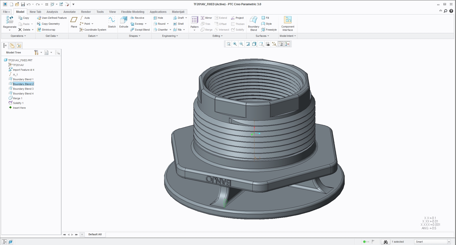

Hi Mauricio,
Here is solid part(Creo3).
You first need to go to import doctor and fix-remove extra surfaces that are messed up then in part modeling add missing surfaces. Merge evrything and then solidify.
If you cant solidify some surface part there are mainly 2 reasons for it:
Quilt is not closed or surfaces are twisted/intersecting.
Cheers
