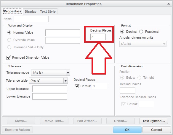

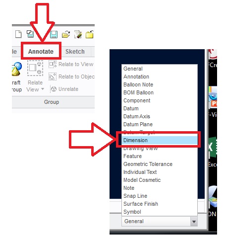

try following in drawing space.
1. Active Annotate bar - set filter to dimmension (right bottom corner)
2.  Select all dimmensions in your drawing (with mouse)
3. Press RMB - select properties - set decimal places to 30
4. Find "bad" dimmensions
Hope it can help
Regards
Milan Bonka

Thanks for the suggestion, this is a nice approach that works well.
