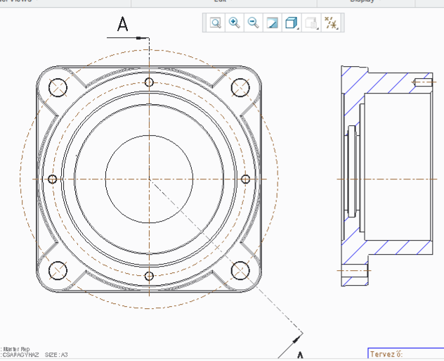

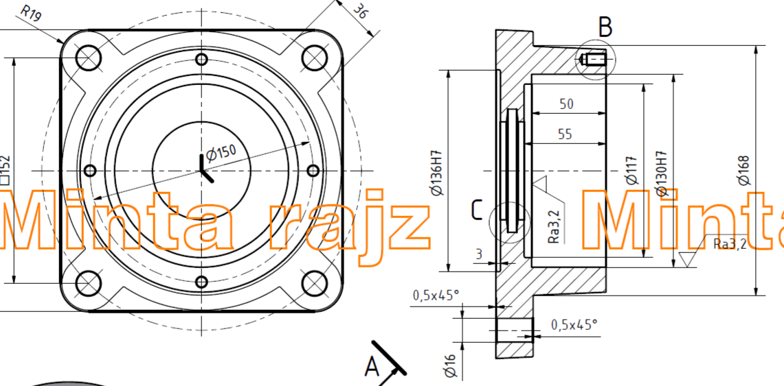

As you can see it in the first picture, the A-A section of this view is the same size as the view. But actually it should be "higher" - as you can see it in the second picture - because of the type of the section. How can I make a section like the one in the second picture?

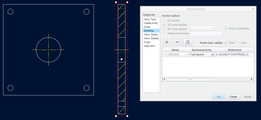

You need to change the section type to Full(Unfold) or Full(Aligned)
