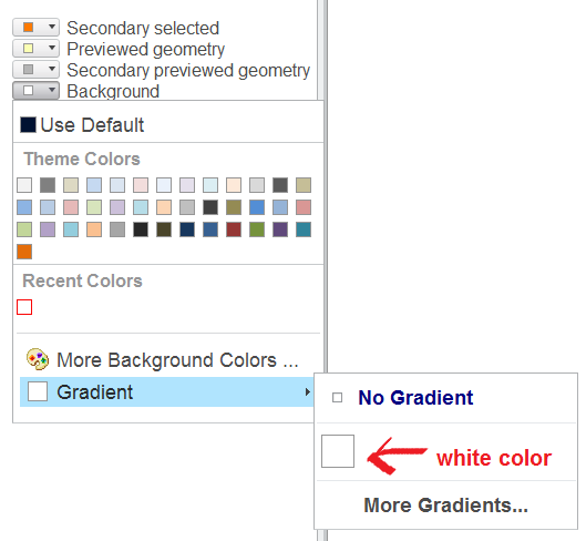

Whenever i change the background of my 3D the background of 2D drawing also changes.
I want 2 customize it to be different color for example.
3D Background>> Dark Background
2D drawing Background>> White Background
Best answer by MartinHanak
in Creo Parametric 2.0:
1.] set white Background color for Drawing mode
Let No Gradient option unset.
2.] click More Gradients... button and set colors for Part mode
You can set two identical colors to get one color background.
MH
February 3, 2016
MH
