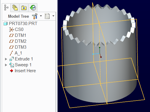

I have a plastic tube, inner diameter 19.0 mm and the wall thickness is 3 mm. I wish to make a circular gear profile. Can anyone tell me how I go about this?
I'm using Creo2.
Best answer by TomD.inPDX
Oddly enough your request is also a simple version of the crown gear.
This is a sinusoidal sweep using "trajpar" in the sweep sketch.
You can do something similar with evalgraph().
Creo 2.0 commercial version attached.
hint: when you modify the sketch in the sweep feature, take a look at the sketch's relations.

Your talking about a crown gear at the end of the tube?
September 17, 2016
My apologies guys. I gave some misleading information so I'll start again!
I have two tubes that I wish to interlock end to end using a sort of gear profile so that the two tubes will revolve as one over a rod. It doesn't have to be a proper gear profile, just a series of 'vee' shapes but the profiles will be proud on one half and inset in the other half. When assembled end to end the proud profiles of tube 1 will sit in the inset profiles of tube 2.
September 17, 2016
