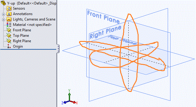

Thanks, but "show datums" was already checked. Unfortuantely that wasn't it.
The attached image shows how another CAD program does it. I circled the plane intersection lines - this is what I'm looking for.

April 22, 2015
Thanks Ron.
To be clear for others who might access this thread, there doesn't appear to be an option in Creo to illustrate plane intersections, such as is typical with SolidWorks and other CAD packages (see "SW plane display.gif" image posted above). The simple workaround is to place axes at plane intersections. If your environment isn't "locked down," you can add these axes to your start part/assembly template.
