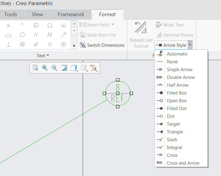

In Creo 4 Parametric, one selects the leader line to change the arrow style of a BOM Balloon.  However, how do I do this on a reference BOM balloon?  The option is not there, and grayed out under customize.
Does anyone know?
Best answer by Mahesh_Sharma
John,
Select Balloon, it will activate Format tab > Change Arrow style from Format group
Mahesh_Sharma
22-Sapphire I
April 21, 2017
John,

Thanks!
