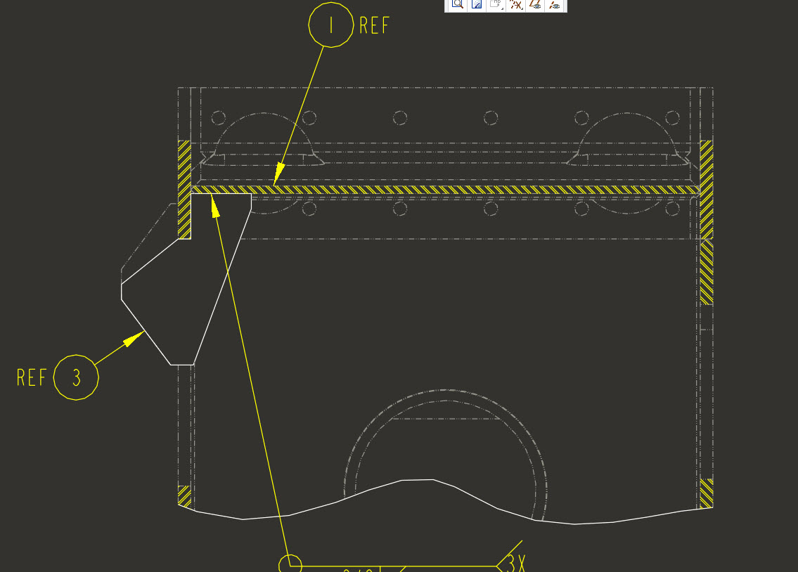

I am working on drawings and need to change the line weight of a cutting line through a cross section. I cannot change the cutting lines using the line style manager and I need a different line style that what is available with cutting_line options in the drawing properties. Is this option available with Creo 2.0?

I have been searching around for an option to map the cross section cut lines, not hatch lines, to another pen in the pen table but cant seem to find what I am looking for. Is it possible to map different types of lines to different pens?
