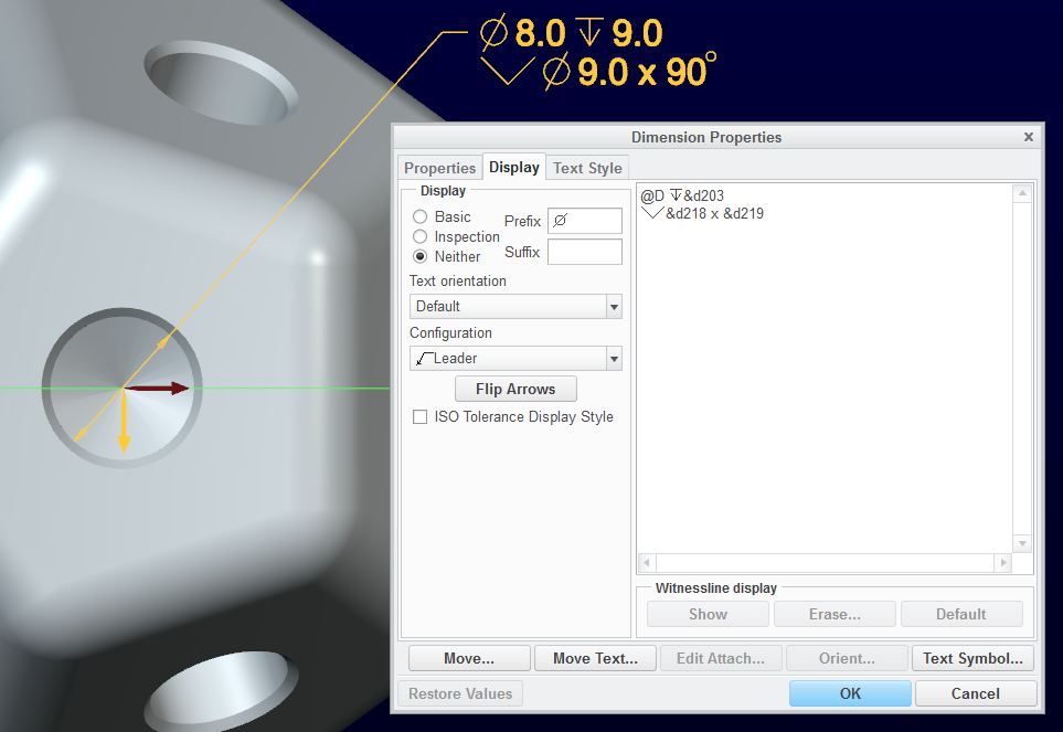

I can get the diameter just fine, but I can't figure out how to get the depth. Google has not been helpful.

Best answer by TomD.inPDX
Those are text symbols. See the lower right corner of the dialog in the image above.
There are several ways to get the dimension values. Use the "switch symbols" button when editing a feature or when annotations are shown.

Are you talking about showing the annotation in a drawing?
The dimension has to be normal to a view. Alternatively, you can use the depth parameter of that feature in a note to maintain associativity.
February 12, 2013
Here is an example that will work in both model annotation and drawing annotation.
February 12, 2013
How did you get that depth character?
