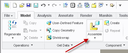

How do you gain access/use the Pro/Assembly include feature.  Was looking for this technology in Wildfire 5 but it was greyed out, now that we are making a move to Creo 3.0 where can I find this option.and how do I gain access to it?
Best answer by StephenW
No. I just tested. I typically use a license that gives me advance assembly (not sure what the name is now), I am able to use Include.
I loaded up our basic license and it told me "Assembly license is required to use this functionality", I'm assuming that's advanced assembly.
in my case, it's the difference between the PROE_EngineerI and the PROE_EngineerIII license, your license names may be different.

I'm in Creo 2 but I'm assuming it didn't change. Select the drop down arrow under ASSEMBLE.
kdavidson1-VisitorAuthor
June 25, 2015
so this is now base functionality?  It is greyed out in Wildfire
June 25, 2015
I believe the include function requires you to have an advanced assembly license.
