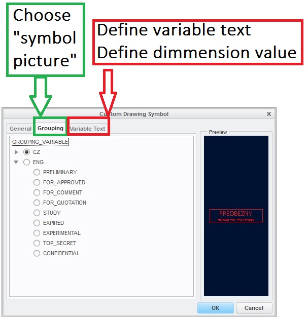

2-Explorer
July 14, 2016
Hello Veronique Monteiro
don´t think it is possible "call" dimmensions in drawing symbol. Something like &d:5 in drawing note.
Try to use "symbol grouping". It is hard to create, but easy to use .
Only disadvantige is: Symbol value IS NOT linked to dimmension itself ---> if you change dimmension, than you have to change symbol value manualy.
An example of my own grouped symbol is attached.
If you need more information about grouping symbols, try to investigate some symbols, that are included in Creo standard library.

July 14, 2016
Yes, it is possible to have a variable text in a symbol calling out a dimension value.  When placing a symbol, in the Variable Text section of the symbol dialog, enter the callout as you would in a note:  '&d0:0', say.  This will behave similarly to other callouts, and has various use cases.
But I think this thread is asking about how to show dimension geometry (the lines and arrows and such of the dimension itself) in the symbol, which is a separate issue and more likely addressed by something like the DXF technique.
