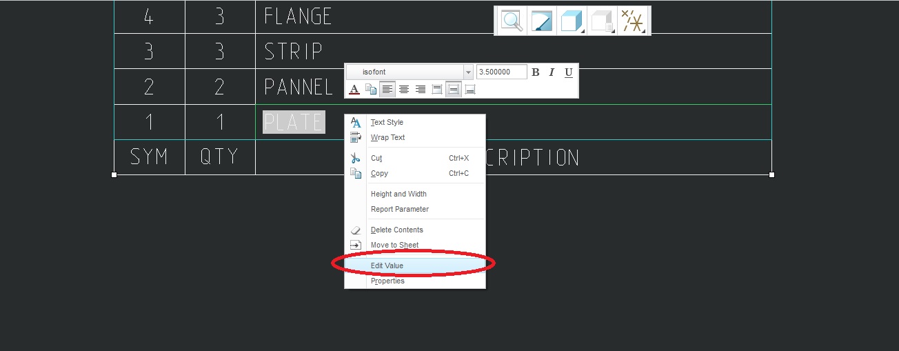

I am frequently using 'Edit value' Option. To do this I have to use right click plenty of time.
Please suggest alternative way to save time and also not to use options by right click.
Thanks in advance.

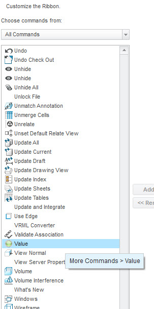

If you don't want to mess around with mapkeys and want to use the ribbon, then adding the "Value" command (mentioned elsewhere in this thread) will work (I did not know that one!), but I suggest that using the ribbon is actually slower than right-clicking.
But there is a fast way of using the ribbon: add the "Value" command to the quick access toolbar.  Then the first 9 commands on this toolbar are accessible by hotkeys ALT+1, ALT+2, etc...

Hi Sumit,
Please add the Value option, to the ribbon.  This will allow you to edit the value.
Amit
