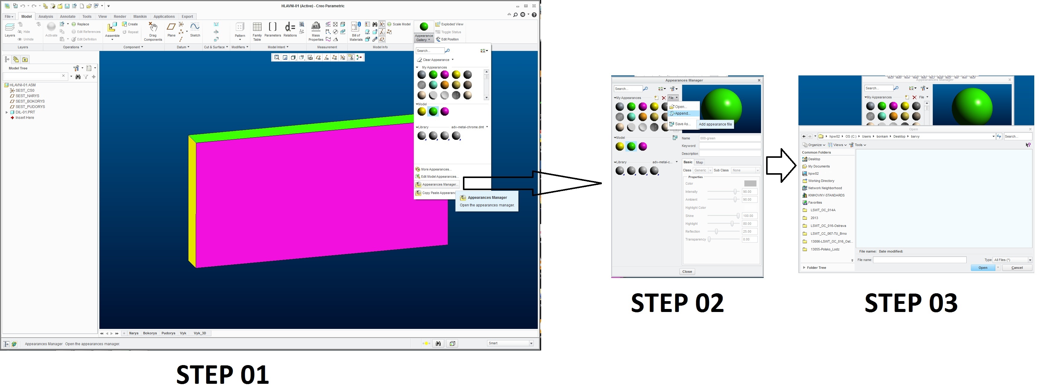

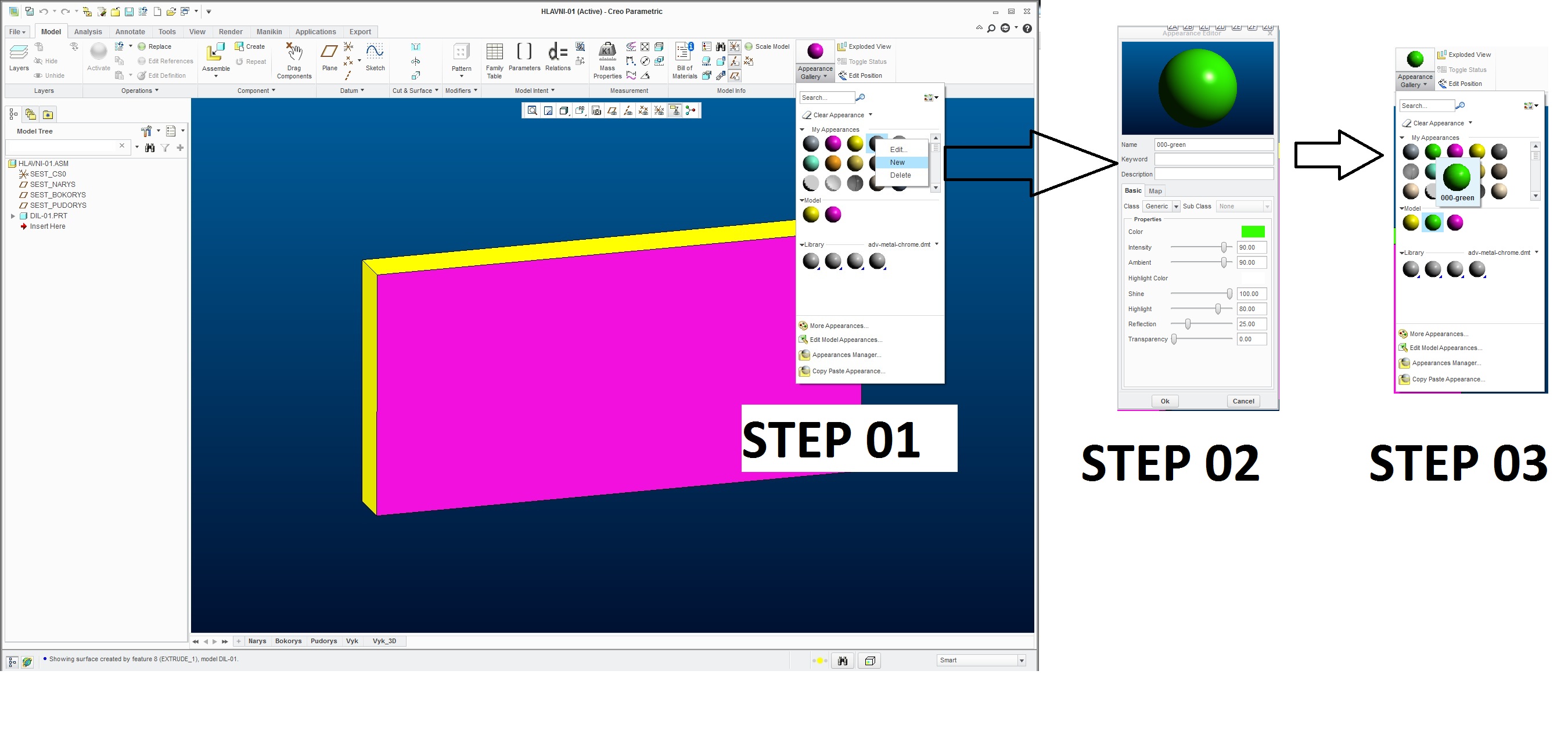

Hello Tomas,
what l know, there are 2 basic possibilities of adding appearances into gellery:
1. Add 1 by 1 appearances
STEP 01 - click right mose button on some coloros, that you want change
STEP 02 - edit color als you wish (change color name) --- when finished confirm OK
STEP 03 - new color was add into your project appearnaces library
2. Append / merge appearances galleries
STEP 01 - open appearnces gallery and click APPEANRANCES MANAGER
STEP 02 - click file (its a small hide button) and choose APPEND
STEP 03 - choose second *.dmt file from your PC that will be append/merge (CZ note --- připojen) to first one gallery --- confirm OK and galleries should be add
NOTE:
l´m not absolutly sure, but there can be some restriction about numbers of appearances in one gallery. l think it´s can be somewhere around 256 colors.
Hope it can help...
