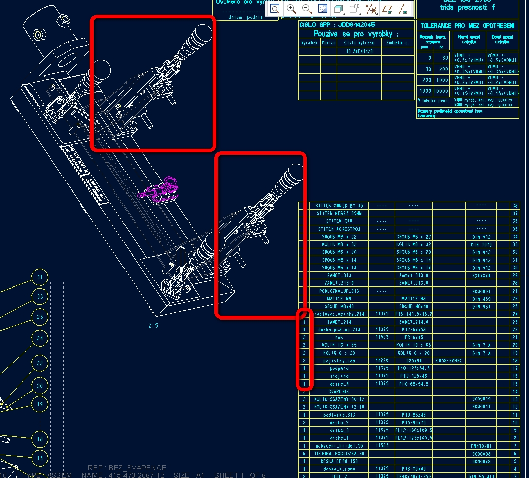

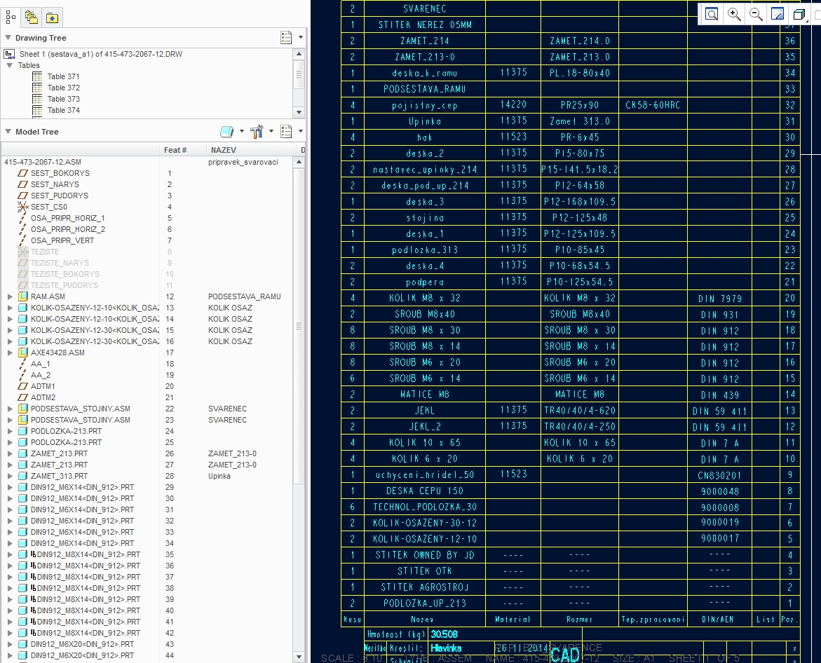

I would need to arrange parts in bill of material so that they are in the same order as in the model tree.
i guess it is made by "sort regions" option but i have never used it...
The BOM now looks like folowing:
Thanks in advance

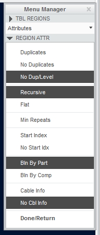

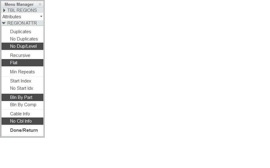

Hi
Try this:
Select Repeat Region->Attributes, select the table and then set the region attributes as follows. region.jpg

Thanks for your quick reply.
As i noticed the command "recursive" shows all parts (including subassemblies) in the BOM - thats exactly what i need.

Since my employer has a bit specific needs in terms of bill of material, i would need to show all parts of subassembies in BOM. It means if there are for example two subassemblies that are the same - in the BOM there should be 2subassemblies (it is ok) but each part of the subassembly should be shown 2times too. In the repeat region below it is wrong:
Is there some way to manage it?
thanks in advance

thlavinka1-VisitorAuthor
November 28, 2014
Hi Jakub
is there some way to add a relation to the rep.reg. to multiple some parts of the subassembly (showed on the pic) by 2 since there are 2 subassemblies in the drawing and your company uses it that way?
On the pic i added one more column where i wrote all quantities according our needs.
thanks in advance

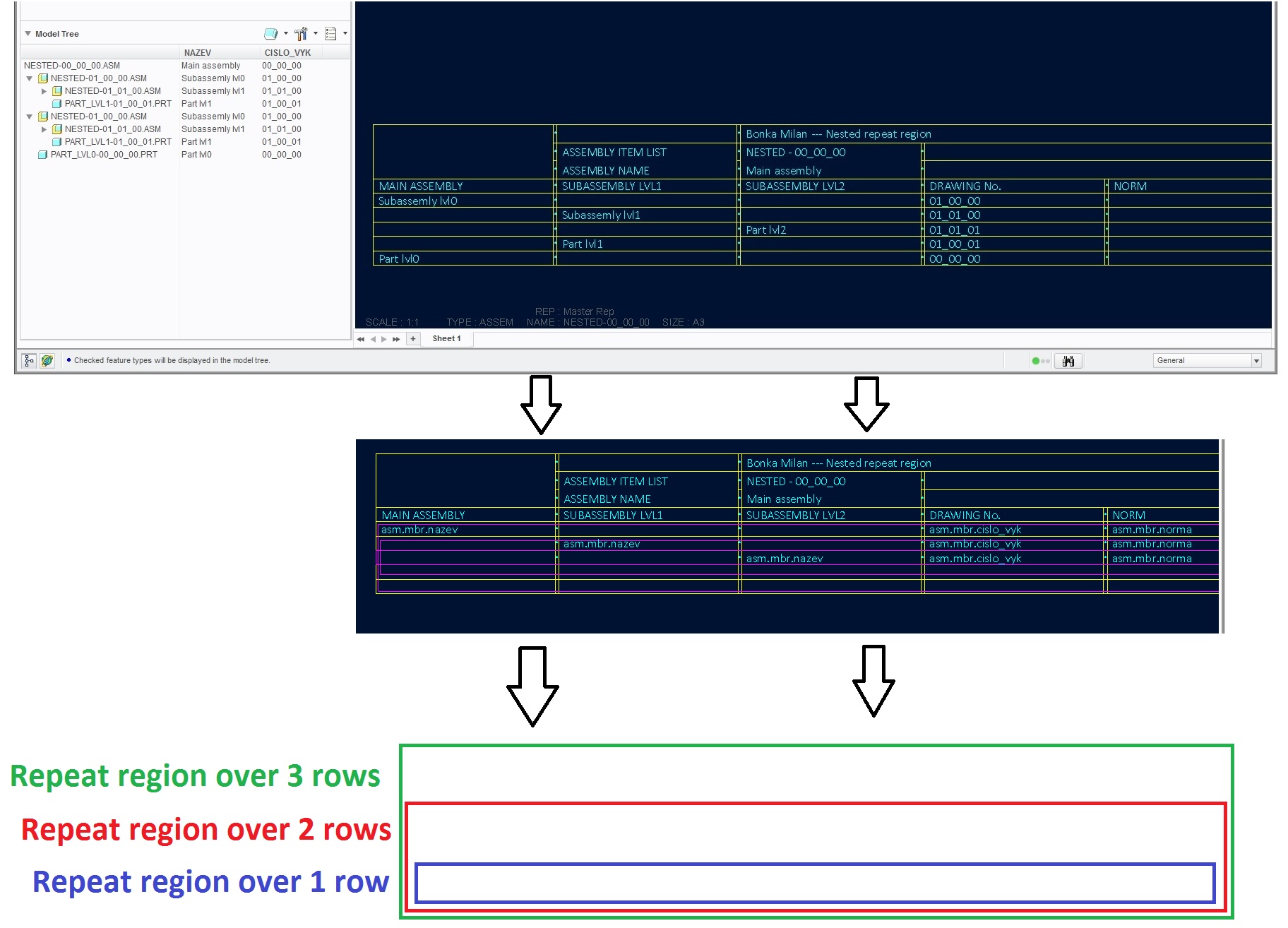

Hello all,
don´t understand what you exactly need. But NESTED REPEAT REGION can be a solution of your problem. Please see Creo help center or PTC forum for more information.
How does it work?
It will create a table that shows model tree structure.
For me it´s not easy describe how to create a nested repeat region. But in generall it´s a repeat region inside other repeat region. How many times you will put a repeat region into other one = so many sublevel assemblies you can show in table. (Czech translate: Repeat region vnořte do druhého repeat regionu. Toto můžete opakovat a podle počtu opakování vnoření se určí kolik úrovní podsestav budete v tabulce zobrazovat.)
This way l created a tables for different subaseblies levels.
Asembly structure lvl0 - it is a simply repeat region
Asembly structure lvl1 - shows 1 level of subasemblies
Asembly structure lvl2 - shows 2 level of subasemblies
Asembly structure lvl3 - ........
Usually l have 4 levels of subasemblies in my projects.
See attached files. There is an example of lvl2 table. It needs to be configure for your parameters.
Note:
Presents of slim colums with stars "*" is from the reason of easy import table into Excel. During import a TXT file to Excel you will choose "divide colmuns with user mark" and the mark will be star "*".
