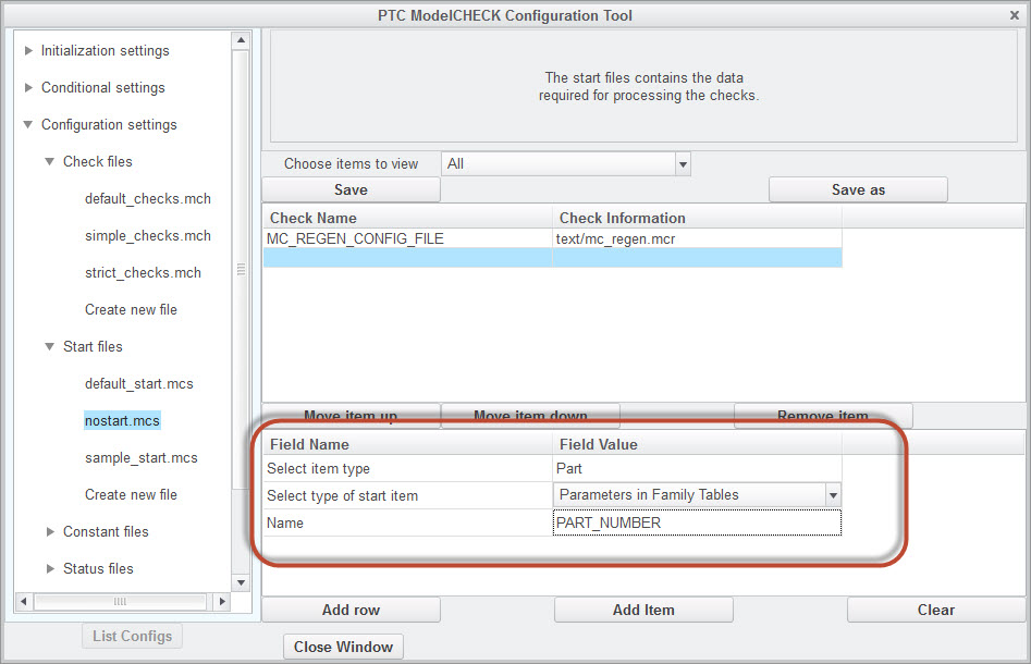

Yes, you can use ModelCHECK to add parameter in family table instances (Not sure about interaction with Windchill).
1. Set Check parameter FT_STD_PARMS as E in check file.
2. Add ModelCHECK parameter [MODE]_FT_PARAMETER [Parameter_Name] in start file (e.g. PRT_FT_PARAMETER PART_NUMBER)

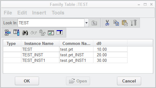

Generic part is test.prt (with parameter part_number) and family table was as:

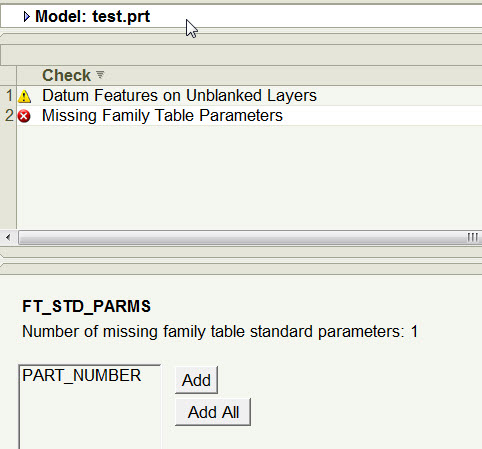

After executing ModelCHECK, results were reporting error and added all parameters.

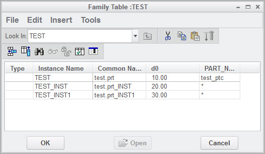

End result was as:

Hi
In family table , the instance name is different to generic & instance .
But ,the parameter part_number remains same for Generic & instance because the instance will derive the value of part_number ( tools - parameter) from generic.
It is showing conflict when we are uploading into windchill because the part_number same for two different object (Generic & Instance) .
We found the solution for above issue by adding part_number as a parameter column inside family table dialogue box & remove the value of Instance (blank) & keep generic value .
Have more than 200 family table parts like this & its difficult to open all the family table parts and adding part_number column .
what I am expecting is when I am running Model check from generic,It should show part_number column is not present in family table dialogue box whether to be added or not if it is added what is the value for generic & Instance .
It would be better , if there is any solution in model check ?
