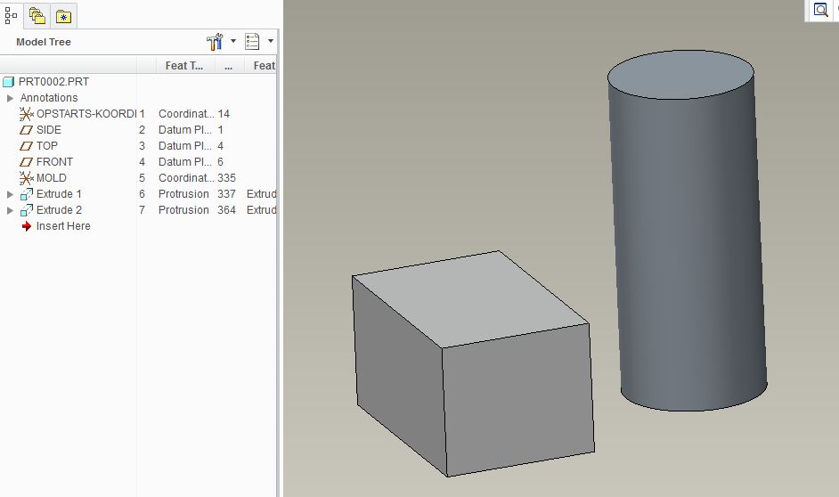

Is there by any change a way to color an entire feature in a part, without selecting every single surface?
In other words: Can I somehow query select all surfaces on a feature?
In the example below I want to select all surfaces of the box, without selecting them induvidually. Is it possible?

I would try Seed & Boundary or Solid Surfaces RMB.
Click on a surface (Left click), to select the entire feature.
Left click again on the same surface. That should select just the surface.
Press and hold <Shift> and left click an adjacent surface. Release all the buttons and all the surfaces should be highlighted, with the exception of the last one you clicked on.
Press and hold <Ctrl> and left click that final surface. Release the buttons and all the surfaces are selected.

Thank you John.
The first method works great.
If the features intersect, it seems that there is no easy way though.
It would be great if you could select the feature in the model tree and apply color to that feature only, even if it intersects with other features. For example if the cylinder was placed halfway inside the box.

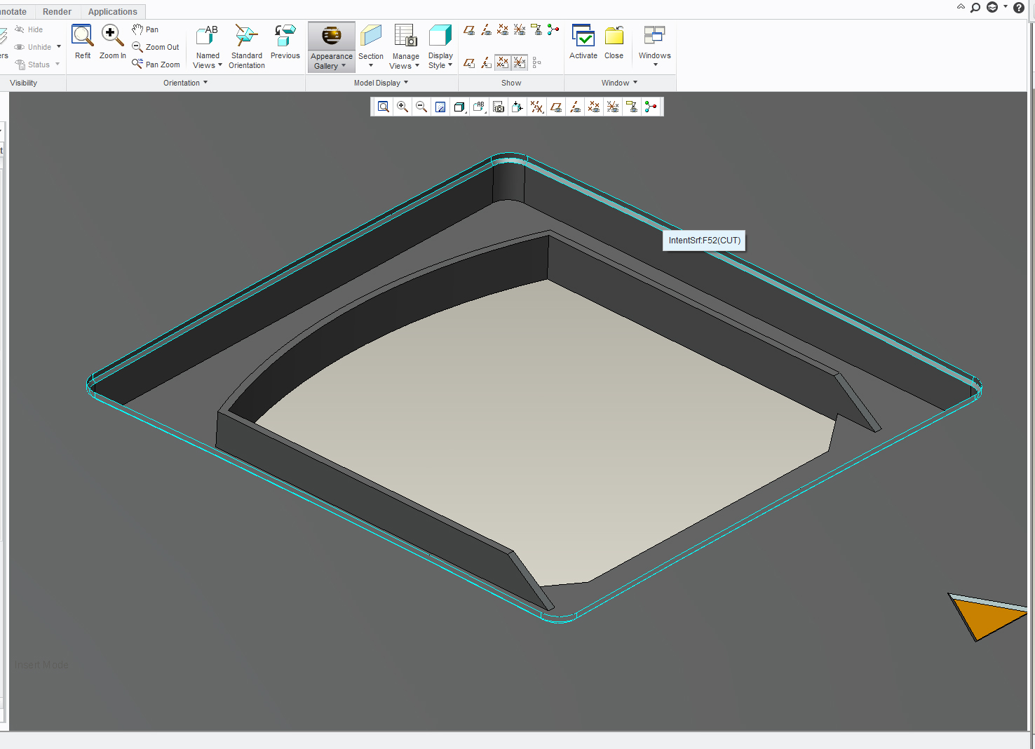

You should be able to select 'intent surfaces' of a feature. This won't get you the entire feature's surfaces, but will get you close. For example, all surfaces created by entities of the sketch of an extrude are on 'intent surface'. This option may not be available for assigning colors, however, I'm not sure.
Right click through the selections or use 'pick from list' in the RMB menu to find intent surfaces.

Thank you all for your help.
There seems to be several solutions (workarounds)
I can't really get what I want with the seed and boundary. Maybe I just don't get how it excactly works.
The finder tools is very usefull and help me select the surfaces that I want.
Finally, while fooling around trying your suggestions, I found out that I actually can query select what I want.
See picture below.
I click the colored sphere, hover over one of the wanted surfaces, query select untill all the surfaces in the cut are outlined and then left click. Voilá. All surfaces in the cut are colored.
